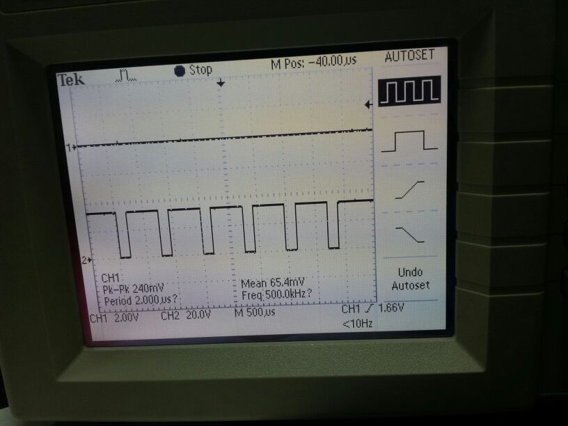

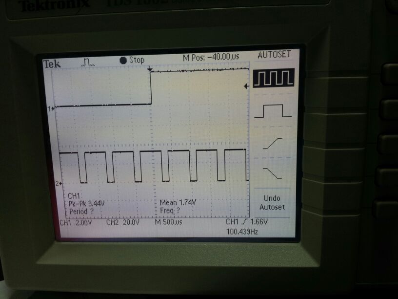

  • Thank you Mr. Bob for your quick response. I am attaching image(photographs since no PC facility) of my oscilloscope signals. Top signal is DIN & below signal is SCLK. I am sending 0x40 and 0x01 through DIN line.
    Now the below signal is DOUTabove along with SCLK below. I am recieving 0x02 instead of 0x01.
    I would also like to mention that my cable length between controller and the ADS1148 EVM is about 1 feet since I am connecting the kit's connectors to my assembled PCB pin of my instrument which we are using for our other application. Please tell me where I am going wrong?
  • Hi Dhiren,
    I apologize for my delayed response as I was out of office.  If you notice, there is a difference between the two scope shots.  On the first one you see the data changing on the falling edge of SCLK and the bottom one shows the data changing on the rising edge.  The ADS1148 needs the input data to be stable on the falling edge as that is when the device latches in the data.  The same is true when you read the data with the micro, as the ADS1148 has stable data on the falling edge and changes on the rising edge of SCLK.
    Bob B

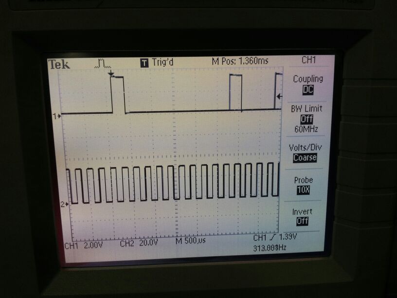

  • Hello, Mr. Bob. I am again sending  my oscilloscope snaps of SPI communication. Before that I want to tell what I am actually sending and receiving.  First I send 0x16 code which is SDATAC command. Then I send 0x40 which is the write command and then 0x0f which is the no of registers = 15 to write. After this I read Data from SPI through DOUT line without sending any dummy code or NOP.  Instead of data = 15 I am getting 0 through DOUT line. I am also sending the logic flow of SCLK, DIN and DOUT line which is as below:
    Write SPI(Send Data) Procedure:
    1)      I make SCLK = 0, and then wait for 100Us
    2)      Put  data into DIN line and again wait for 100Us
    3)      I again make SCLK = 0 and again wait for 100Us. Here I expect data to be recieved by ADS1148 at falling edge of SCLK.
    4)      Then again I wait for 100Us and make SCLK = 1 and again wait for 100Us. Then I repeat  steps 2 to 7 until 1 byte of data is received. Oscilloscope snaps of send data is as below. Upper signal is Data IN line and lower signal is SCLK line.
    Read SPI(Receive Data) Procedure:
    1)      I make SCLK = 1
    2)      After delay of 100Us I make SCLK = 0
    3)      After delay of 100Us I make SCLK = 1. This is the rising edge of SCLK. I expect data to change here
    4)      After delay of 100Us I make SCLK = 0. This is the falling edge of SCLK where data should be stable
    5)      After delay of 100Us I read the 1st data from DOUT line at falling edge of SCLK.
    6)      After delay of 100Us again SCLK is made = 0 and steps 2 to 6 are repeated until 1 byte of data is read. Oscilloscope snaps of send data are as below. Upper signal is Data OUT line and lower signal is SCLK line.
    Please advice me where I am going wrong?
    Dhiren
  • Hi Dhiren,
    There are a couple of things.  First of all, you don't need all those delays.  For example, you can change the edge of SCLK to high and right away change the data out to the device.  When reading you change the edge of SCLK and then read the input pin.  When reading you only need a few nano seconds before the output of the ADS1148 is valid.
    The result of adding all the delays is that you are now violating the duty cycle requirement.  Look at the Figure 1 and table on page 12 of the datasheet.  There is a tSPWL and tSPWH requirement which means you must have a period where you cannot have a portion of the period less than 1/4 of the total SCLK period.  Try to have a 50% duty cycle where 1/2 the time the clock is high and the other 1/2 of time the clock is low.
    One observation is although it is true that there are a total of 15 registers, you probably don't want to write to all 15.  For example, you probably do not want to write to the calibration registers (0x04 through 0x09) and unless you are using the GPIO you probably don't want to write to the last three registers (0x0C through 0x0E).  In most cases you will right to the first 4 registers, and perhaps the two IDAC registers if you are using the IDACs.  This can be done in two write registers blocks.
    The actual write register command is the WREG command plus the starting register (first byte) followed by the total registers being written less one.  That means if you are going to write one register of data this byte would be 0x00, or when writing 15 registers it would be 0x0E and not 0x0F.  So the correct bytes for writing 15 registers starting at register 0 would be 0x40 0x0E.
    If writing the registers in two blocks, as I mentioned earlier, the first command is 0x40 0x03 followed by 4 bytes of data.  The next write block would be 0x4A 0x01 followed by 2 bytes of data.
    When reading back the registers the command is similar, except the RREG command is 0x20 instead of 0x40.
