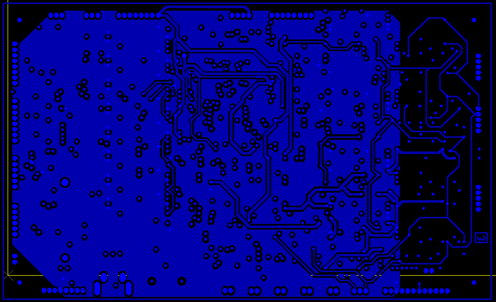

    Can you verify the Gerber file. It is 4 layer PCB.

    Attached herewith is Gerber file.

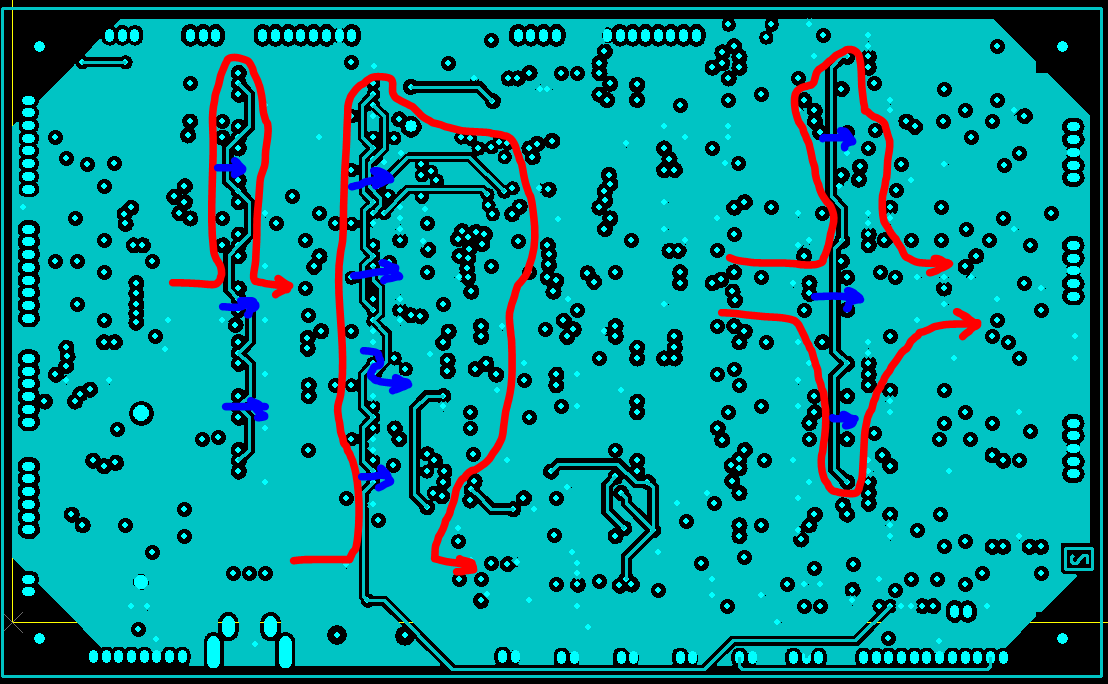

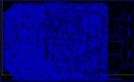

    The first thing I looked at was your ground plane and I noticed that you have traces in this layer. The problem with these traces is that they block the flow of return current. Any current that is trying to flow in the path of least inductance below it's signal trace will be re-routed around the traces in the ground plane (see my annotation below). This greatly increases the return current loop area and will introduce parasitic antennas on your PCB. This is probably the #1 cause of noise and EMC problems with PCB layouts. If you can remove these long traces from the ground plane you will see a difference!
    I know your board is crowded, but at the very least you need to reduce these current loops by providing multiple alternative paths to current to flow (for example, where I've shown blue arrows). A better solution is to ensure that no trace blocks the return current path. The best implementation would be to have no traces breaking up the ground plane (traces around the outside of the board don't break up the ground plane, but they can be more susceptible to noise pick-up from external sources).
    The same principles also apply to the plane on the VCC layer.

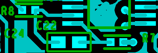

    • Minimize the trace lengths that connect the PGA differential filter cap to CAPP and CAPN pins on ALL ADS1282's. Remember to remove the connecting resistors (R7, R8, etc...)
    • Connect these two DGND nets (under U6) on the top layer to decrease impedance to DGND. I think you can shift the via to the right to make this connection.
