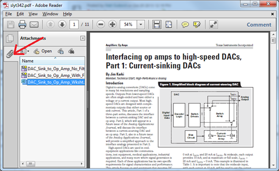

I am using the app note from TI found at the link below.
www.ti.com/lit/slyt342
The app note says that there are resources that go along with their proposed circuit, but the link just points me to a zip file with the original pdf file in it. Is there anywhere I can get these resources. I am building a spice model in LTSpice that should be equivalent to the one in the app-note, but it does not give the same output voltage swing and I am not sure why. I am also unsure why the model uses a VCVS instead of a CCVS to represent the CFA. Any help would be appreciated.
