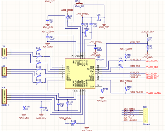

I decide to use ADS1293 and MSP430F6659. For ADS1293, I use external clock. From datasheet, I know that the Frequency of Crystal is 4.096MHz, but I cannot buy in Ho Chi Minh City, Vietnam. I have replaced with 4MHz crystal, and It's still not work. Any problem here?
I also attached my schematic below,
  • Hello A Do Tan and welcome to the E2E forum. Hey, and no problem, I can read you perfectly.
    This difference in the external crystal frequency should not be a problem such that the device does not work at all. Do you have the part number of the crystal that you are using? I can take a look at it.
    At first sight the schematic looks correct... the only error I could spot is R15H, which should connect from CMOUT to RLDINV and not to GND. But this should not stop the device from working, only the Right-Leg Drive circuit would not be functional.

  • Thanks for your reply quickly.
    I just have proved as you said:
    VDD = VDDIO = 3.3V
    CVREF = 2.40V
    RLDREF = 1.49V
    So I think these voltage are correct.
    I try to read from address 0x00 and 0x40, the value return is always 0x00. Then, I write value 0x02 to address 0x00 and get back and it's also 0x00.
    I removed R15H and mount R 100k Ohm from CMOUT to RLDIN. but It's still not work.

  • Oh my god. The reason is at RESET PIN. I don't know but although I placed a pull up resister 1MOhm, and It's still 0V when I probe at RESET pin. It's mean that my ADS1293 is always at reset state, so that why it's not work. I replaced with 10k Ohm  resister and now it work OK.
    Thanks for your helping me again.
