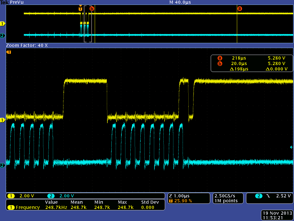

    Signals are attached

  • Hi Matt,
    Thanks for the info.  The thread title refers to the ADS1247 and the datasheet you are referring is for the ADS1147.  They are similar devices, but the datasheet is different for the two devices so that is my confusion.
    I don't see anything in the communication shots you sent that would create this type of delay.  One thing that could cause the issue is if the command is being misinterpreted.  This could be noise related to SCLK and the data in to the device.  As an example, the WREG might appear as SYSOCAL.  In your zoom in shot I missed the command and just see the data.  Can you send me that portion of the zoom in? Also, does the mux actually change?  Can you send me your schematic?

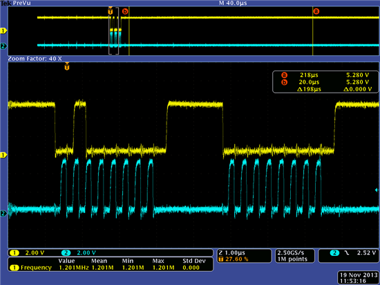

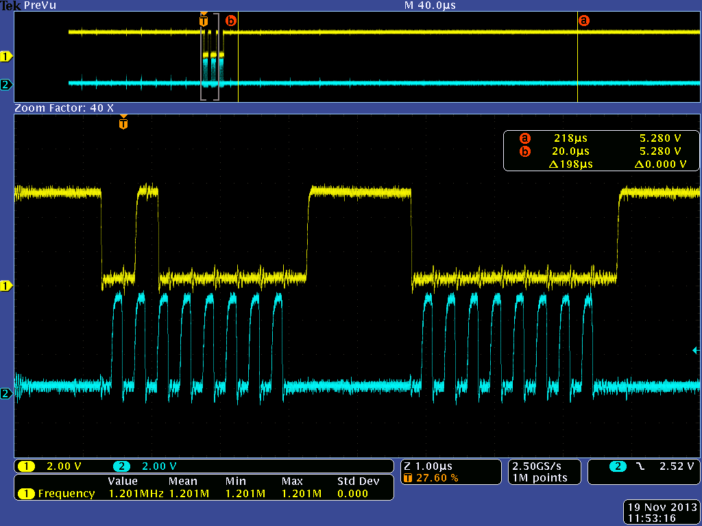

    Attached is the data image.  Got cut off when I converted my doc to pdf
    In this case it is writing to reg 0, byte count 0, data 0x1  for ain0/ain1,   The curious thing is that if I write 0x1 every time instead of every other time, the timing is still off. But if I write 0x13 every time (ain2/ain3) then I get a samples at the 2k rate.
  • Hi Matt,
    It looks to me that you are close or maybe over the maximum SCLK frequency.  Try slowing down the SCLK.
    Bob B
  • Lowered it to under 1meg. Made no difference.  It appears that SYS0 is getting clobbered. If I read that after the first data is read, it has reset to 0, from 9.
