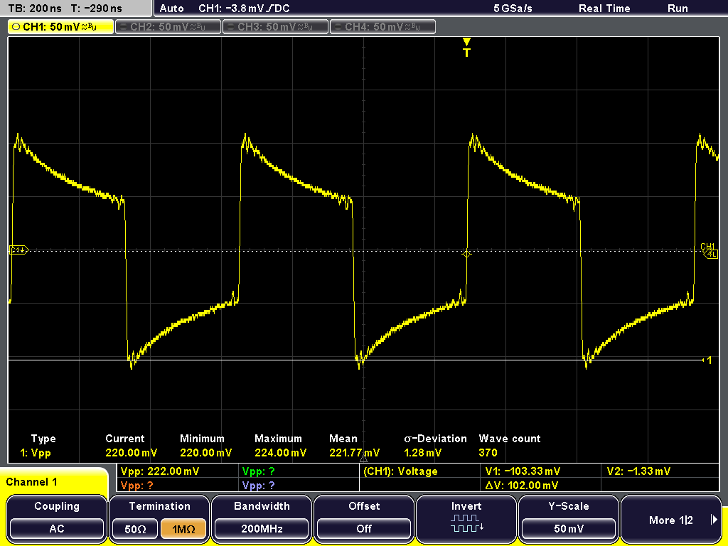

I have a bit stream of 1s and 0s. And I am making a digital signal out of it. If it is one I have some amplitude which is positive and if it is 0, I have a negative amplitude. Basically half of the csv file has 32767 as its value and another half as -32767. I load this file in the high speed data converter pro software and I see a square wave, which is shown in the attached file 'data_in.png'. I load this type of data into the DAC3482 and I observe some decaying waveform at the output, it is shown in the attached file "data_out.png". I would like to know why is the output not constant. I kindly request your help at the earliest as I am stuck with my project.

    The DAC348x EVM by default have transformer coupled with a bandpass response. This is the reason that you see transients being passed through the transformer but not the final DC value being settled.
    For proper square wave output, you will need to terminate the DAC resistively. You may do so by connecting 25ohm load to positive and negative leg of the DAC output. Refer to the EVM schematic for the zero ohm jumper options and path needed to do so.
