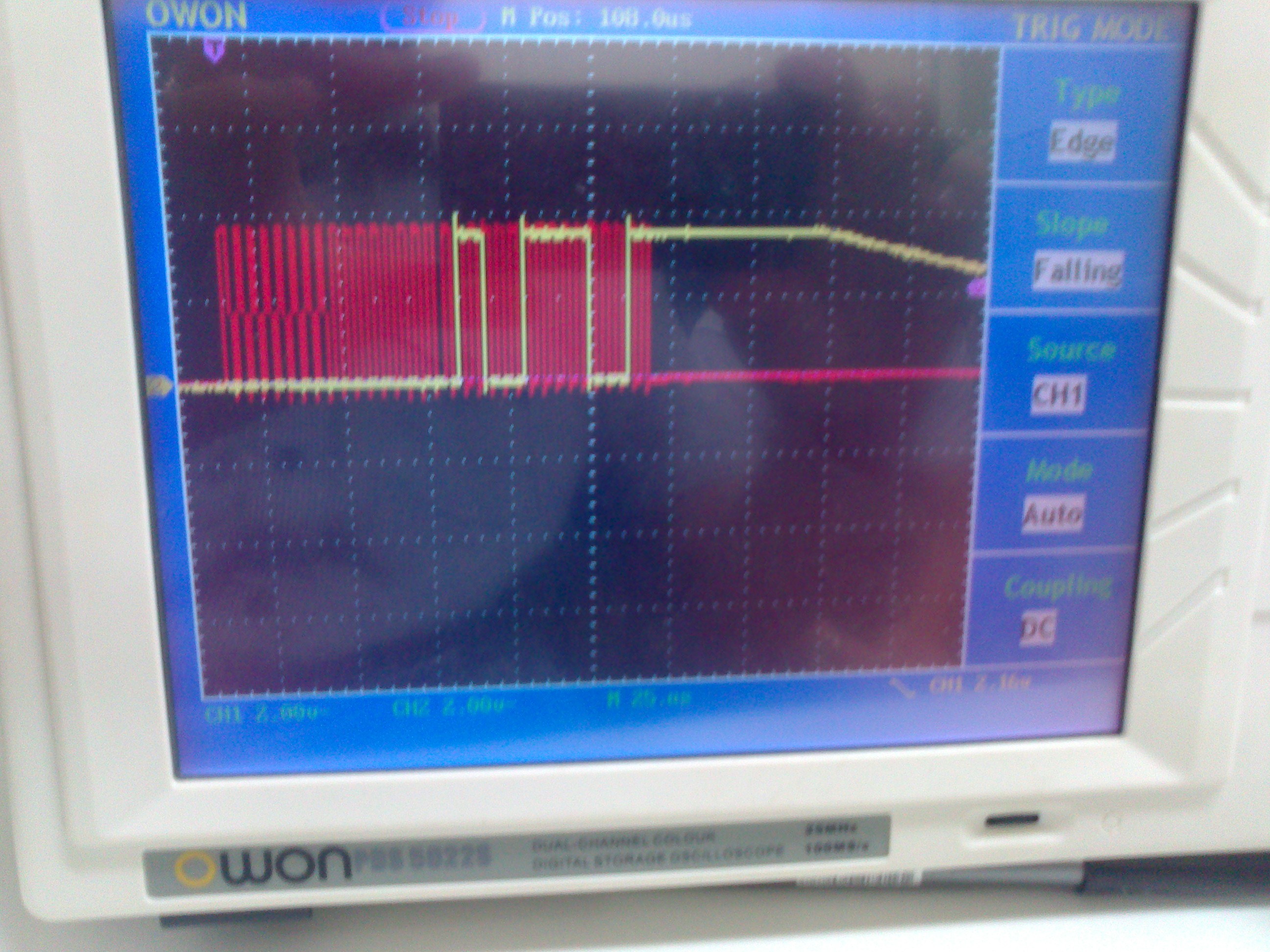

We are facing a problem with the ADS1118. We made a circuit using 2 ADS1118 to communicate via SPI with an ATMEGA328P to read voltage or current.

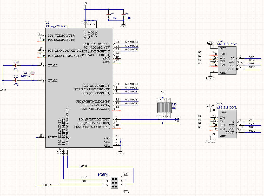

Schematic:

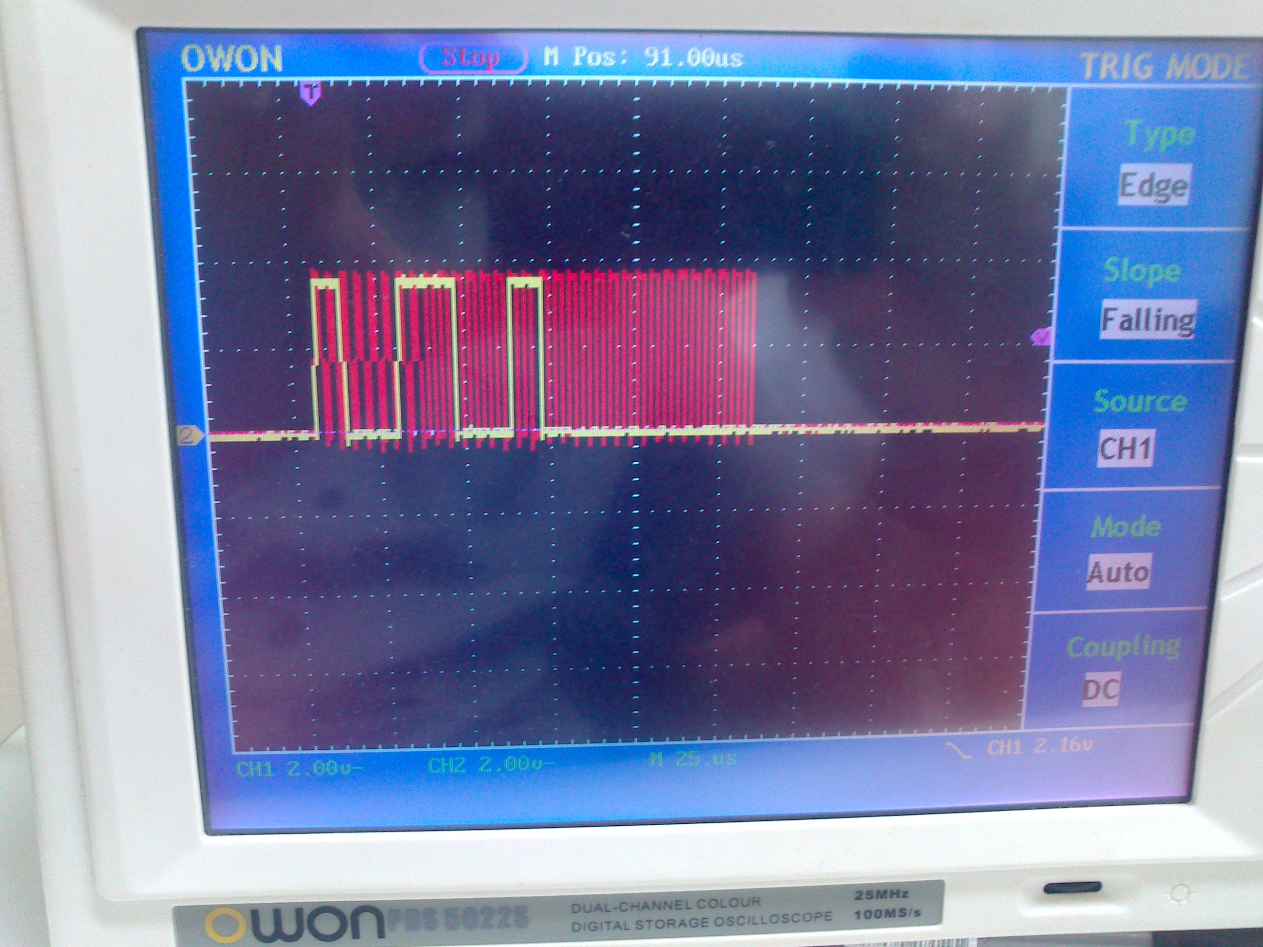

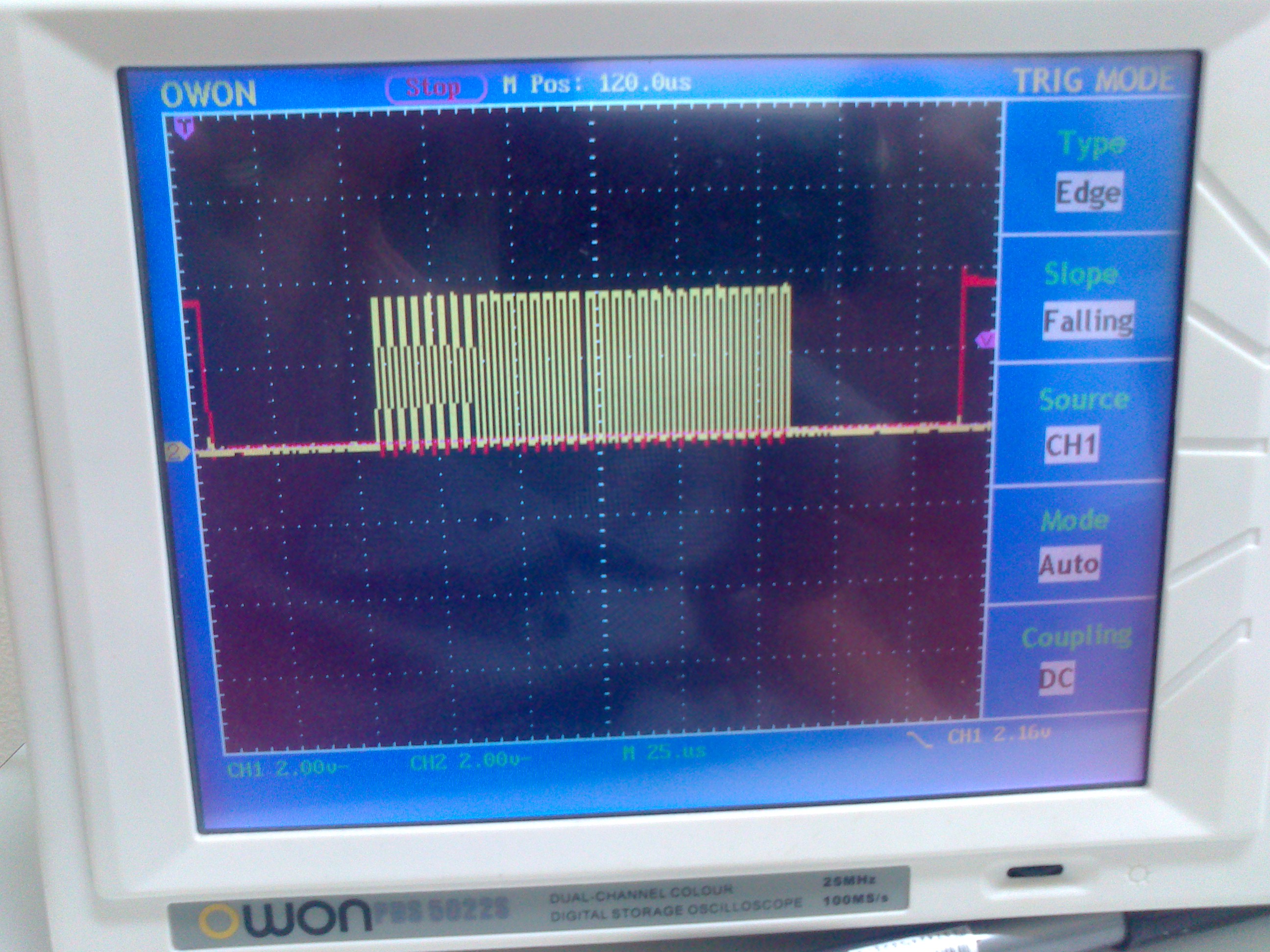

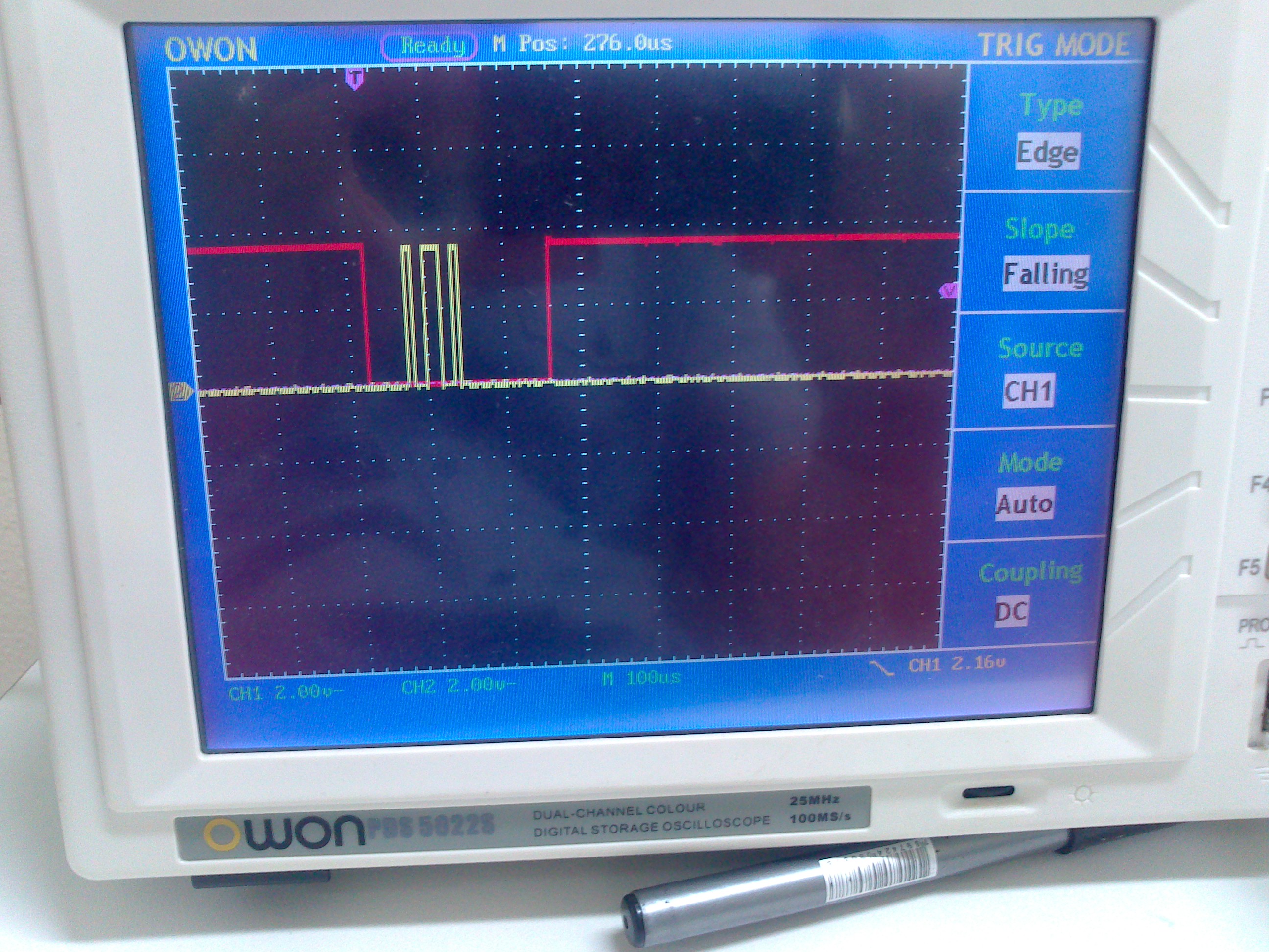

Pictures from scope:
CS (Red) / SCK (Yellow)
CS (Red) / MISO (Yellow)
CS (Red) / MOSI (Yellow)
SCK (Red) / MISO (Yellow)
SCK (Red) / MOSI (Yellow)

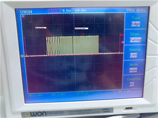

    • The first byte of SCLKs/Data in each transmission have some sort of issue.  You need to have clean clocks and data.
    • Your schematic shows a 5V supply, but the data is coming out at closer to 3.6V.  If AVDD is 5V and your micro is 3.3V, then the ADS1118 needs 3.5V (0.7*VDD) for logic high and this will not work as expected.  If the ADS1118 is powered by less than 4V and 4V is applied, the part can be damaged by overvoltage of more than 0.3V greater than VDD.

    All ICs are in the same board. Quite small one, no net is longer than 2 or 3 cm. The different GND and VCC were because we use isolators. We thought that they could generate a gap in the potentials, so we jumper them. No used on that though.
    R: Not sure what you mean here.
    About supplys: All ICs are under a 5V supply. Doesn't look like in the scope, I know, is a shitty scope.

    Here is the detail of what I was talking about with the SCLK:
