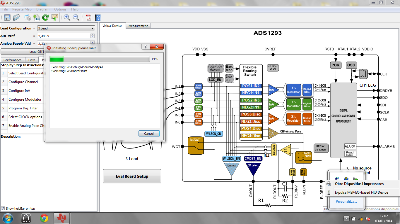

I'm working with ADS1293EVM with my company computer. Everything is all right.
Now, i installed software and drivers in my personal computer and work in my home, but i have some problems.
The installation of soft and drivers are fine. The personal computer recognizes the ADS1293EVM board. When i open software, it is block in initiating board (14% Executing: WvBoardEnum).
Screen capture:
Somebody know what's this problem. I can't proceed to work with board and soft.
Thanks.
Please, I hope your help.

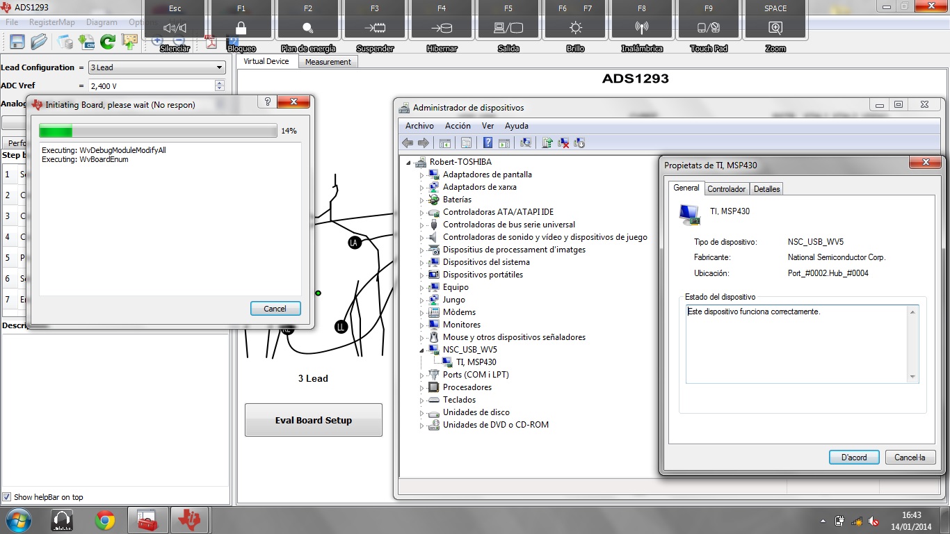

  • Hi Robert,
    Do you have the same operating system on your company computer as in your personal computer?
    How is the board identified by the device manager... can you share a screenshot?

  • Hi Sergio,
    "Windows 7 Professional" in company computer.
    "Windows 7 Home Premium" in personal computer.
    It's the same for two computers (TI, MSP430) and all of them recognize the board. But the ADS1293EVM software of my personal computer can't run. Always stops in this stage (see image).

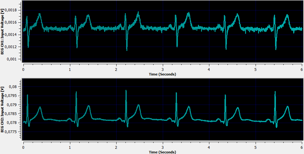

    I can see two similar ECG signals with 3 Lead mode but a lower frequency is coupled. This produces a slow oscillation in ECG signal.
    Which kind of digital filter is done via MSP430 or software?
    Maybe a problem in these digital filters?

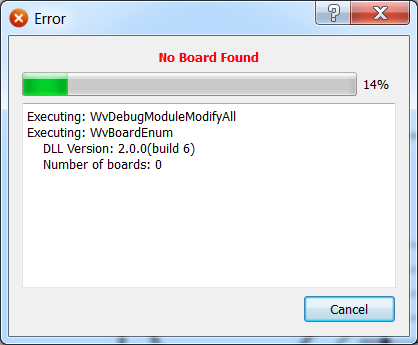

    It's strange that the GUI runs correctly on your work computer but it doesn't run on your personal computer, even though they have comparable operating systems. I have not seen such condition in the past. Does the GUI ever give you a message like this? This is the message I get if the board is not plugged in.
    You may want to try hooking the board up to another USB port or using a powered USB hub and see if that helps.
    Regarding your second question. It is possible to have 50/60Hz from your surrounding interfering with the system, which is seen as a slow oscillation coupled to the ECG signal. Neither the software nor MSP430 implement digital filtering, however, the ADS1293 does have programmable low pass filters on each channel. The filters are configurable by registers (R1_RATE, R2_RATE and R3_RATE_CHx). Tables 5 through 8 in the datasheet summarize all possible configurations with the corresponding bandwidths and data rates. You may try a cutoff frequency of 40Hz for example.

  • Hi Sergio,
    Thanks very much for your help.
    I'm working with my personal computer and obtain a good ECG signals.
    First problem is an issue of administrator domain for Windows OS.
    I don't know the reason why my computer execute GUI without administrator domain. Only have one user in computer. This is my user and is administrator user. All softwares are executed as administrator domain by default until now. But this is not the case.
    I changed the properties of executable and issue resolved.

    Finally, I would like to contribute referring to the placement of the electrodes. I found a lot of problems if you use different electrode placements.
    Avoid placing the electrodes on muscles. His movement affects seriously the ECG signal. I ended up placing two electrodes near the shoulder bones and the next two hip bones. I get this ECG signal using this placement.

  • Hi Robert,
    So changing the properties of the executable to "Run as administrator" solved the problem.
