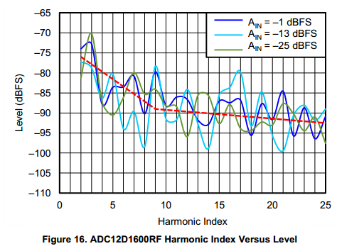

I am using the EVB for the ADC12D1800RF, and noticed a problem with the HD3 performance:
sampling rate is 1800MSPS, with test signal at 124MHz.
when signal level is -1dBFS, the HD3 is about -70dBC (after I perform calibration).
when signal level is lowered to -25dBFS, the HD3 becomes -50dBFS, meaning it still has about same power, despite of the signal power reduction.
same thing happened when I changed signal frequency to 248MHz etc.
note that I'm using the EVB along with the balun EVB (that has 1:2 transformer+100ohm resistor on it), with external DC-Blocks.
can you explain this odd HD3 behaviour?

     This behavior is expected with a folding and interleaving ADC architecture. The harmonics measured by the ADC are a combination of the input track and hold stage (which are linear) and from the inherent nature of folding and interleaving (non-linear).  You can see from the below plot that the harmonics are mostly dominated by the latter non-linear harmonics. In fact changing the input level hardly has an impact on the level of the harmonics.
    You can read more about where the harmonics come from and methods of mitigation in the following application report:
    Maximizing SFDR Performance in the GSPS ADC: Spur Sources and Methods of Mitigation (http://www.ti.com/lit/an/slaa617/slaa617.pdf)
     Please read the report and let us know if this answered your question.
