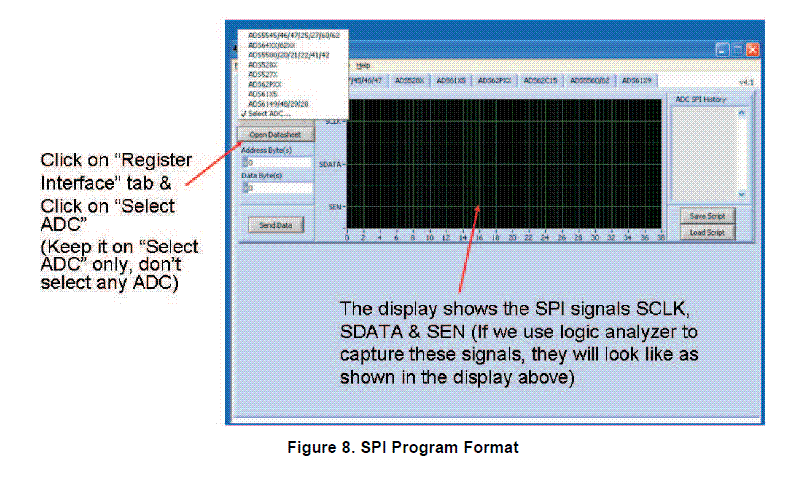

  • I can't find the ADS5400 option in the TI ADC SPI (TSW1200) control software either.  I also tried copying the ads5400.ini file into the directory where the software is installed.  Unfortunately, that did not help.
    Prab Sandhu
    The ADS5400.ini file is not for the TI ADC SPI software, just for the TSW1200 software.  The TI ADC SPI Interface is a separate GUI with its own installtion CD that should have shipped with the ADS5400 EVM. The version of the TI ADC SPI Interface that ships with the ADS5400 is currently version 5.0, and it does not have a 'tab' on the top of the window for ADS5400 like it does for other device families.  As described in the User Guide for the ADS5400 EVM, the TI ADC SPI Interface supports the ADS5400 as a pre-release EVM through the 'Register Interface' tab and then SPI writes may be performed by entering address and data.  From the ADS5400 EVM User's Guide:
    However, we will be moving away from having a single SPI GUI supporting many EVMs in favor of a dedicated SPI GUI for each device family, and so we won't be upgrading the TI ADC SPI Intercace to add a device tab - we will instead provide a dedicated ADS5400 SPI GUI.  But for now the TI ADC SPI Interface (version 4.1 or 5.0) can be used to control the SPI interface to the ADS5400.
    If you are looking to control the ADS5400 SPI *using* the TSW1200 instead of the TI ADC SPI Interface GUI, as mentioned in the ADS5400 EVM User's Guide, you will be able to do that when we get the version 2.1 version of the TSW1200 software to you.  The option to control the EVM SPI by way of the TSW1200 was added for TSW1200 version 2.0 and newer.

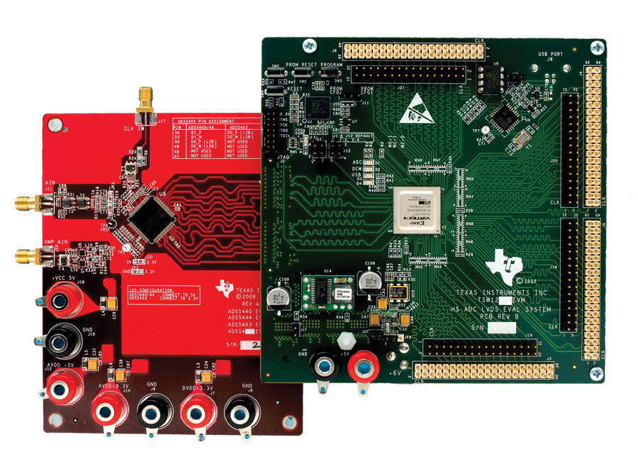

    If you have the ADS5400 EVM then it plugs into the TSW1200 directly.  There is not a cable for conencting the Samtec connector from the TSW1200 to the ADS5400 EVM.  Please see the atached picture showing the ADS5463 EVM plugged into the TSW1200.  In fact, the stand-off legs of the two boards are adjusted in height so that the two boards can sit on a table or bench and stay plugged in.
    Richard P.
