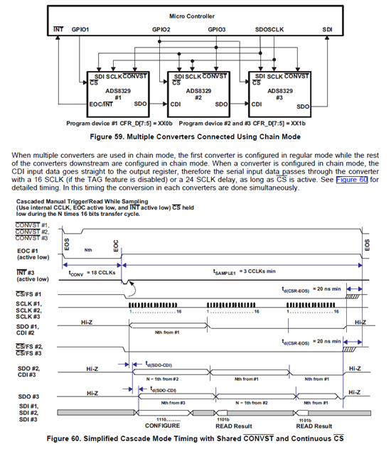

I'm reading the datasheet for ADS8329 regarding chain-mode as configured in figure 59.  The SPI data out shown in figure 60 is kind of confusing to me.  All get the same CONVST, and why SDO#2 sending out N-1th sample while #1 and #3 are sending out correct Nth sample.  Is that a typo?  I checked other scenario, but none show data with all Nth samples which I was expecting for chain mode configuration! I would appreciate anyone with more info.  Hopefully that's a just typo...
