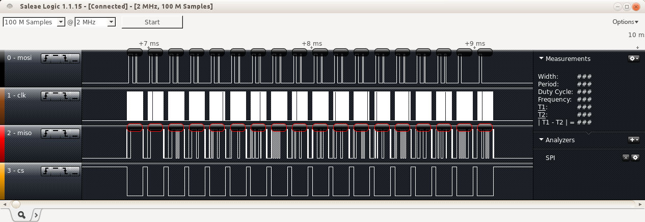

I was pretty confused by this output, so I hooked my logic probe to the SPI but only to see that the values reported in my program were the actual values reported by the ADS chip.

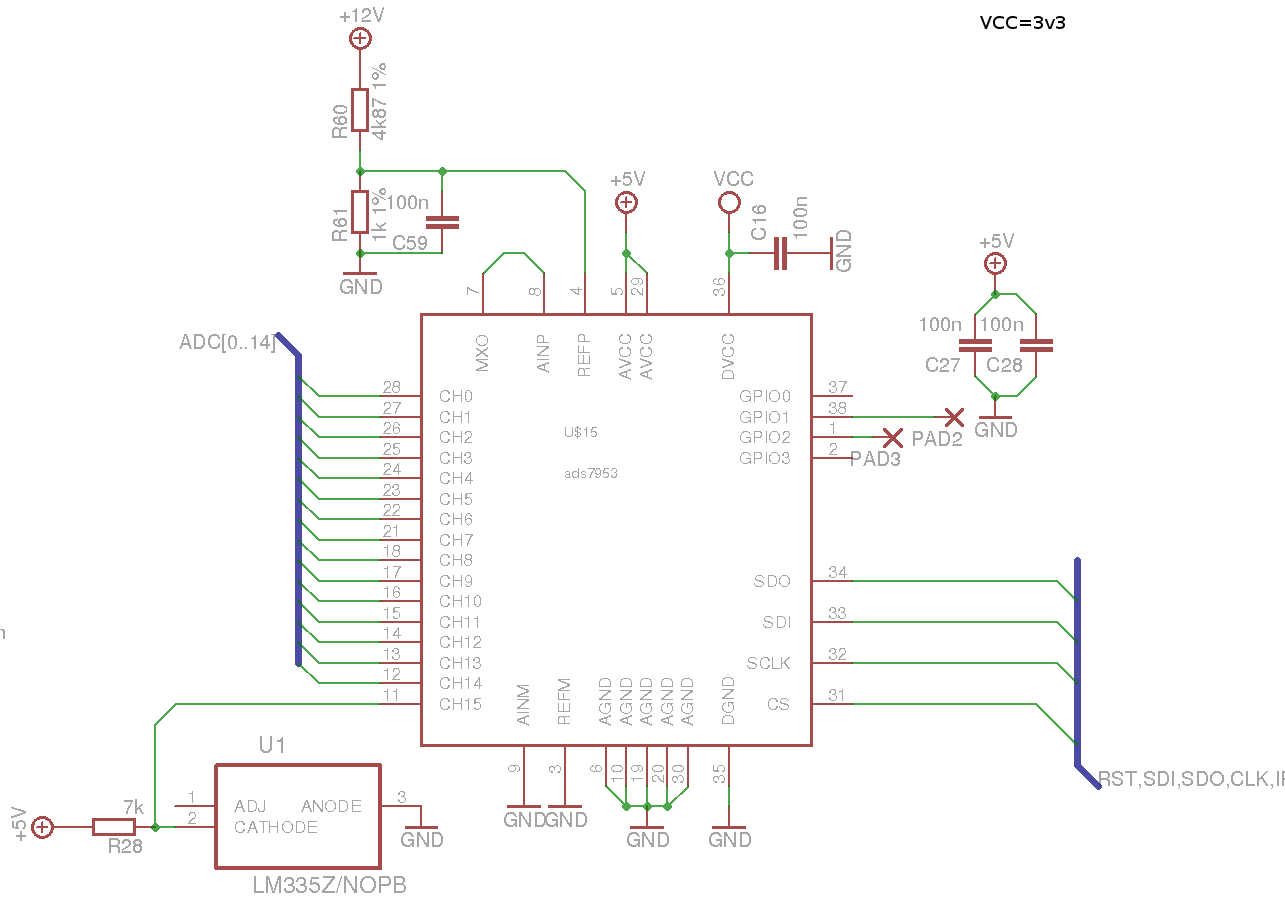

    The sensor I use is an LM335z with an 7k resistor on the cathode.
    If you want I can email you the schematics, but maybe this snapshot is sufficient.
    I want to state here that after investigations all channels report always 0xf as LSB's.

    The logic analyzer capture of your SPI interface seems correct. The waveform does not show the second CS high pulse, but I am guessing this is a LA capture issue.
    However looking at the schematic snapshot, it appears that the Vref is derived directly from a power supply using the resistor divider and changes in current can impact this voltage. Ideally, the REFP pin should be driven with a stable +2.5V (for Range 1 operation) derived from a reference IC such as the REF5025 as described in page 42 of the ADS7953 datasheet.
    Just to confirm that this is the source of the 0xF on LSB behaviour that we are seeing, could you try observing the REFP pin on an oscilloscope along with the SCLK? The device internally switches modes as it evaluates each bit and at the 11th falling edge of SCLK you should see a dip in the voltage at the REFP pin. This dip would explain why the last 4 LSBs (driven on clocks 12th to 15th) are coming out as 0xF.

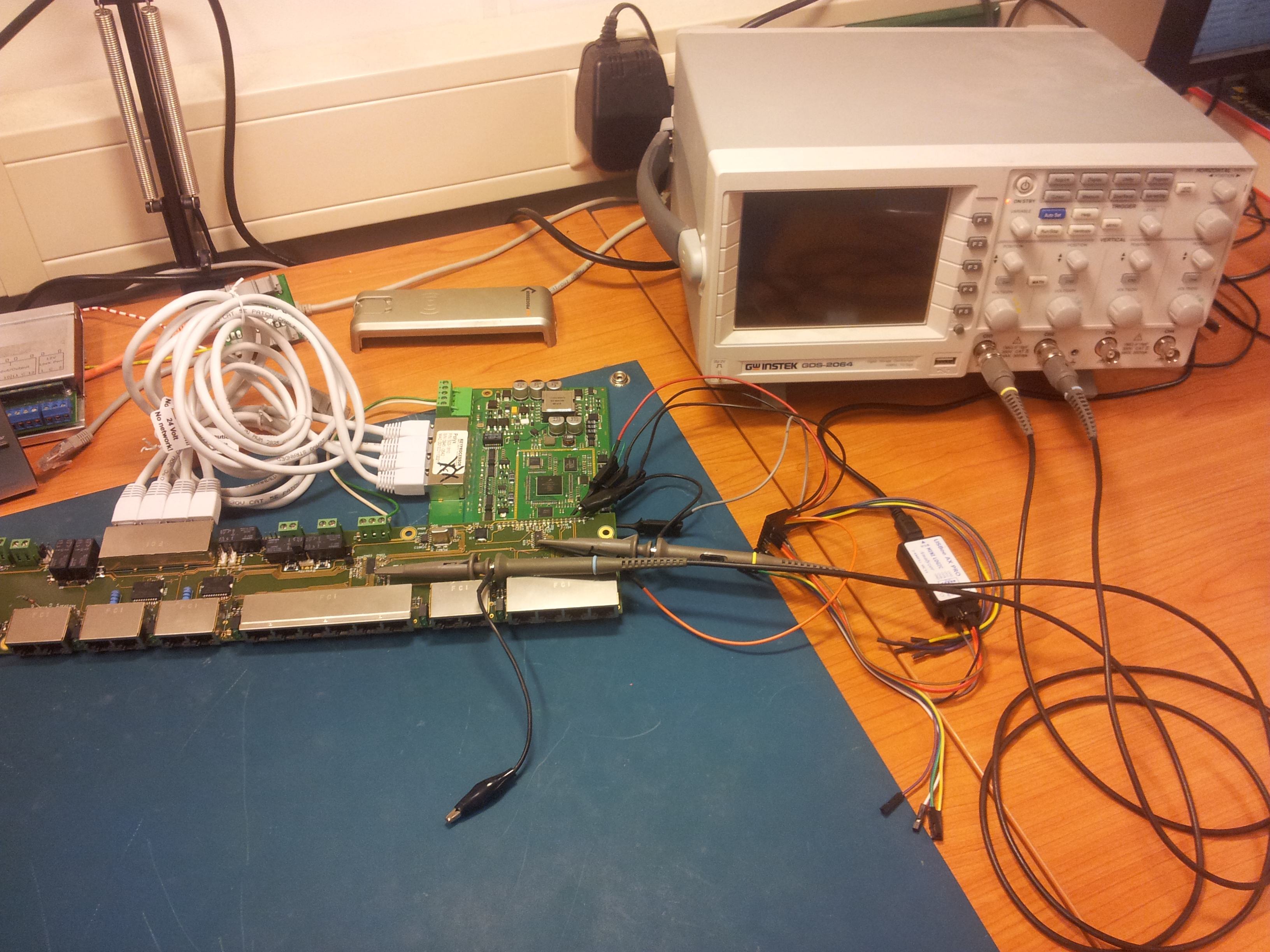

    My setup is like this:
    The data what has been sent and received according the logic probe:

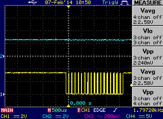

    And this is the data from my scope, channel 1 is the CS and holds a trigger channel 2 holds the Vref :
    I hope we can solve this problem.

  • Sebastiaan,
    I tried modifying an ADS7953 tester board here to setup the reference the way you have it on your board. As expected, the conversion results came out bad. However, I am not able to get the last nibble stuck at 0xF. I currently don’t have a clear experiment to explain that behaviour.
    Nonetheless, the reference on your board needs to be fixed. For the ADS7953, the LSB = Vref/(2^12-1) = 2.5/4095 = 611uV. With a resistor divider to derive the reference, the actual voltage that the ADC uses for its comparisons would vary based on small shifts in the load current and impact the output codes. It is recommended to drive the REF pin with a low noise reference like the REF5025, as mentioned in page 42 on the datasheet.
