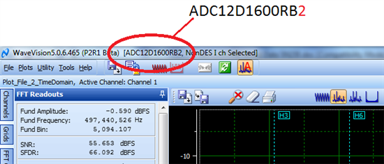

    You can open WaveVision and see what FPGA image is being loaded. It is displayed once at startup and all the time at the top of the window (shown below).
    Here I'm showing version 2 of the board. ADC12D1600RB2. We can use this number to determine which clock is installed.

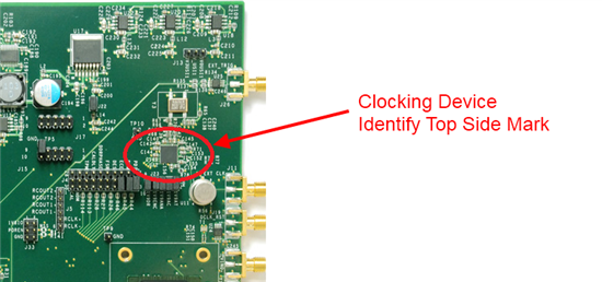

    Or you can also inspect the board and read the top side mark of the clock device directly shown below.
    You can enter this information into the part marking tool which will translate it to the corresponding device: http://focus.ti.com/general/docs/partmarking/partmarkinghome.jsp
    The two clocking devices we have used are the LMX2531LQ1778E or the LMX2541SQ3740E.

     The LMX2531 is run at 1800MHz and outputs the VCO directly. It has the option to use the output divider of /1 or /2. If this is the version you have then you cannot output 1200MHz.
    The LMX2541 is run at 3600MHz and uses the output divider to get 1800MHz. The output divider has a much greater range, /1 to /63. We currently use /2 to get 1800MHz. If you use /3 you can get to 1200MHz.
