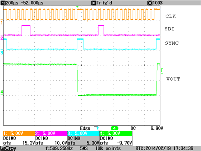

    I am using the DAC7811 EVM evaluation board with an IAR STM32F407 development board. The SPI signals are connected by jumper wires and are noisy.
    This is the scope capture, the top trace is SDIN, middle trace is the SYNC, and bottom trace is SCLK.  I sent 0x1400 to set the output to +5V on the first command. The second command was 0x1c00 to set output to -5V. In the default daisy chain mode, the output voltage stays at +5V. If I first send the command ox9000 to disable the daisy chain mode, the output switches from +5V to -5V as expected.
    Thanks.

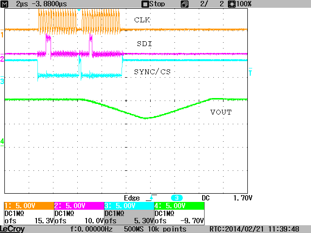

  • I tried replicating the behavior that you observed.
    The plot above is with right after power-on with Daisy Chain enabled (default).
    I alternated between the commands 0x1800 (Write, 0V) and 0x1000 (Write, -10V).
    The part was functional after any write command with Daisy Chain enabled or disabled.

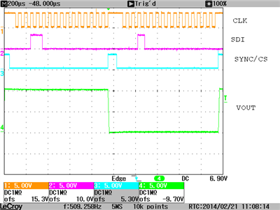

  • I made a mistake on that plot. This the correct one.
    The CLK frequency is aprox. 18.3kHz. From your plot I assume that your capture is using a CLK frequency aprox. 5MHz. I took a plot at that frequency as well. Just be aware that the DAC output needs time to transition at large steps. Take a look at the plot below.
    How are you injecting the signals to the Evaluation Board? A description of which pins you are using or a picture of your setup will suffice.
  • I think I found the problem. it appears the DAC7811 is sensitive to signal overshoost and undershoost because of the jumper wires from the the micro to the DAC7811 evaluation board. I have added 200 ohm serial termination resistors to the SCLK and SDIN signals and the DAC is now working properly.
    Thanks.
  • Overshoot and undershoots on SCLK can create false edges that may cause the device to misinterpret commands. This would not have been my first guess to debugging the problem, but I really appreciate you closing the loop and letting us know how you solved the issue.
