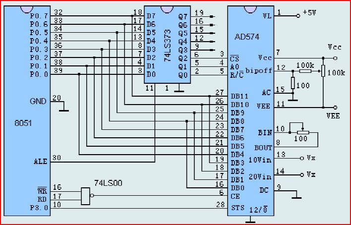

I recently came across AD574 12 bit ADC. I wish to use this in my college lab for demo purpose. I understood the wiring. I wish to get advice for the assembly/C coding/ algorithm for interfacing this ADC as shown in the given diagram attached. Can you please guide me step by step. I am new to 8051 programming and your help in setting up a demo board will be very much appreciated.
Waiting for valuable reply. A assembly code/C code will do.
