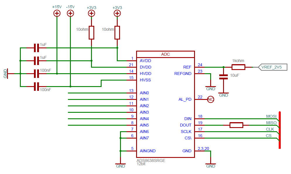

I have a custom made board with several ADS8638 on it and they are supplied like this:

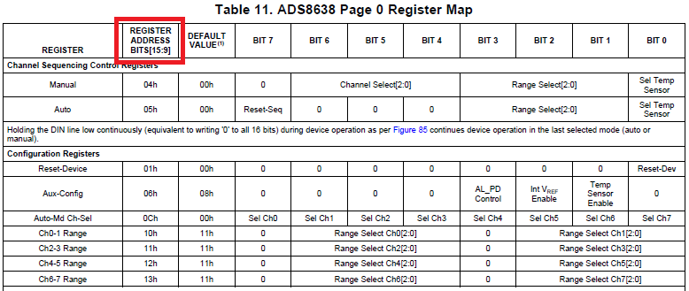

    From the scope screenshot and bits mentioned, the command send to the ADS8638 in both SPI transactions is “read register address 09h” instead or write/read ch6-7 ranges.
    Since the first 6 bits sent are “001001”, the actual register address selected is 09h. Then, the seventh bit sent is ‘1’ for both cases meaning a read instruction. This is shown in the following image:
    Thus, SPI master is sending data shifted with an unintended ‘0’ as the MSB.
    On another note, the resistor between the 2.5V reference source and the reference pin is too large (1kohm). I don’t recommend a resistor larger than 10ohm. The reference pin needs to be driven by a low impedance source to avoid reference unsettling during fast sampling rates. I have seen these types of filtering when using noisy/low-power reference sources. If the reference is too noisy, it needs to be filtered and then buffered with an op-amp. Note than if an additional op-amp is used in between the reference source and ADC ref input, at the reference pin there should still be a 1uF to 10uF capacitor. A 10ohm can be used between the op-amp and the 10uF at the reference input pin, but make sure the op-amp has more than 50° phase margin when loaded with the resistor and capacitor.

    As I understand the datasheet, the ADS8638 expect 7 address bits and not 6?
