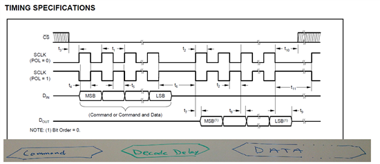

    Is it neccesary to use Delays ? i can wait for DRDY to go high for reading data .
    also i m little confused when i see that timing specification as SPI is full duplex read and write should happen at the same
    time so why this delay in Din and Dout ? .
  • HI Shubham,
    The delay is not with respect to the conversion cycles, but rather to the decode time for commands to be interpreted to know which data is required (register, conversion result, etc.) before data is placed into the output register.  Also, there may be a different delay time as it relates to completion of a command, such as RESET or calibration.
    With respect to reading out the conversion results, it is best to read the conversion results based on DRDY as you have mentioned.
    Bob B

  • Hi Shubham,
    I think you are missing what is happening in the communication.  Please look at the timing diagram of the datasheet.  You must communicate in 8-bit (byte) transfers and not 16 or 32-bit words.  All commands are structured as one byte in length followed by data.  The ADS1218 must be able to decode the command (read register, write register, reset, calibration, etc.) before the device knows which operation is being performed.  The delay is the time between the command and the data.  Also, you cannot use the SS function as it relates to SSI module as total transaction length can vary, and the communcation to the ADS1218 for the total transaction length requires that CS remain low throughout the entire transaction.  So if you use CS on the ADS1218, then you must use a GPIO function of the processor to control CS of the ADS1218 and not the SS function of the SSI module.
    Bob B

  • Hi Bob,
    Thanks for the detailed description . It gave me brief insight about the procedure . This is the sequence i think ADS follows:
    As soon as i keep the PDWN, RESET and DSYNC pins logic high the ADS starts converting data .
    After it has converted its first cycle  DRDY goes active low and then i can use RDATA command to read data .
    In RDATA command i will send write command and will let the clcok on upto clock t6 .
    then i will shut my clock down during t6 and again give clock to read data from slave .
    Is it how it works ?
  • Hi Shubham,
    Yes, the PDWN, RESET and DSYNC must be high for the ADS1218 to run conversions.  DRDY will transition from high to low when the conversion is completed.  If you do not read out the conversion resuslts, the next DRDY will actually pulse from low to high to low.
    This is assuming that you have either the appropriate crystal connected to the XIN and XOUT pins, or are providing an external clock to the XIN pin.  This clock should always be running otherwise the ADS1218 will not work.  This is the clock that is the master clock for the ADS1218 operation and is called fosc in the datasheet.  The period of this clock is called tosc.  The communication clock (SPI SCLK, or in your case the SSI clock) must be at least 1/4 of the fosc clock in frequency.  So there are two clocks.  One must run continuously and the other is just for clocking the data in/out of the ADS1218.  The t6 time is based on the period (tosc) of the fosc master clock.
    So the fosc clock must be runnning all the time (no stops or delays).  The communication sequence is to send the RDATA command (one byte of data clocked through your SSI interface), a wait time where the serial interface communication clock is idle (where the wait time is determined by the period of the master clock, fosc) then the remaining serial communication clocks are issued to read out the data.
    This may be your understanding, but I just want to make sure that you have two clocks for the ADS1218.  The device runs from the master clock connected to XIN (or by crystal oscillator with crystal connected to XIN/XOUT pins), and the ADS1218 will not operate at all without this clock.  The communication clock is a seperate clock that is connected to the SCLK pin.  It is this clock that requires a delay between command and data.
    Bob B
