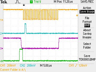

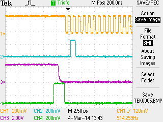

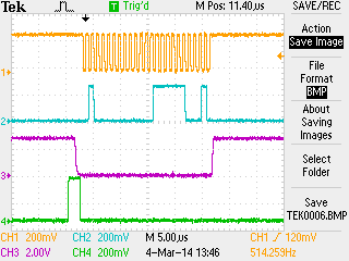

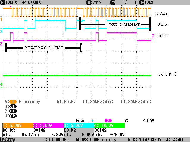

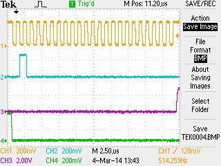

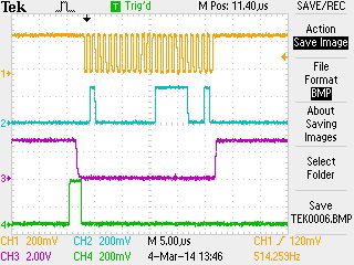

    Here my fig about my SPI input. First I want to set channel 0 (4 first bit address: 0100) and value to be 0x000 (12bit data). I send 2 packages of 12bits continuously for the required frame of 24bits as instruction in datasheet of DAC7716.
    The 2nd signal is connected to SDI pin of DAC
    The 3rd signal is connected to CS pin
    The 4th is connected to LDAC to make tha latch transparent when the clock begin.
    Other register I have not set any value, let it as default from reset...(gain at 4)

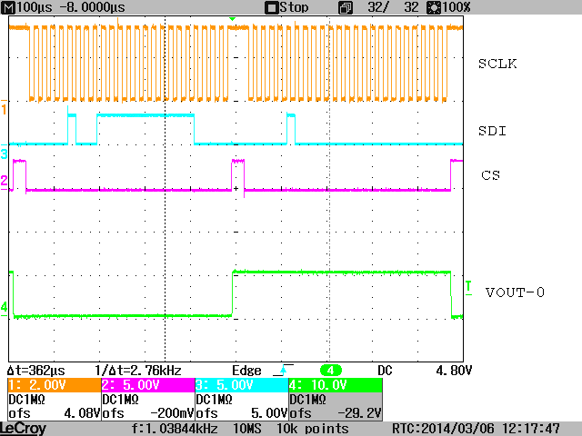

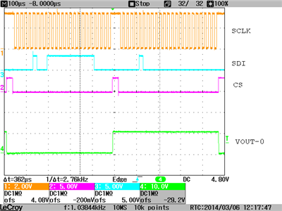

    Some bigger pictures:
    I even change the value of data but the output voltage give the nonsense value (the same for all 4 output channel but I just assign the address for the 1st channel):
    Could you please check and give me advice!!!!
    Duy

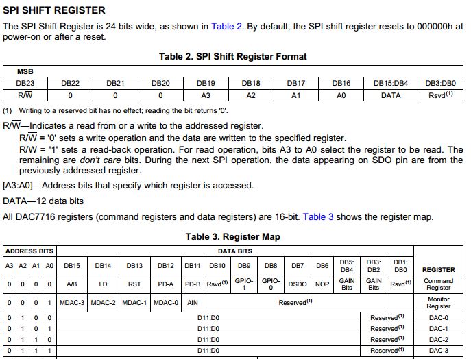

  • Duy,
    From the scope captures it seems that you are writing data on the rising edges of SCLK. The DAC7716 uses the falling edge of SCLK to latch in the data. Shifting your data by half an SCLK cycle should make it work.
    As a side note. If you are planning on using it as a transparent, you can just tie LDAC LOW and the DAC output will update on the 24th falling edge of SCLK. There is not need to pulse LDAC before the frame.
    Let me know if this solves your issue.

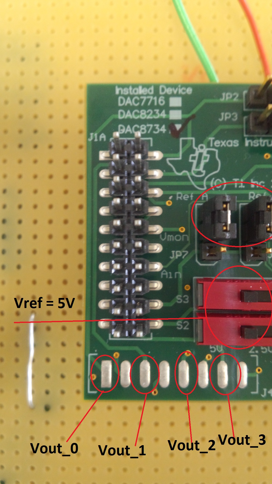

    1) I have 1 DSP board for general purpose TMS320F2885 and the DAC7716EVM.
    2) I used the SPI channel A of the DSP (only 3 pins: CLK, CS and MOSI) which connect directly with CLK, CS and SDI pins of DAC7716.
    3) For the supply input of DSP from the adapter which provide 3.3V for normal operation
    4) Supply voltage for DAC7716: AVDD = +11v; AVSS = -11V; Digital Voltage = 3.3V. Both 2 boards are connected the same GND.
    5) For set up the board, I just let it as default (gain = 4, Ref Voltage from the 5v or 2.5v on board), both channel A & B are set to Bipolar (set switch S1 to 0 for both channel).
    Then I give the SPI input which I have mentioned above, but the out put is just nonsense. (usually the Vout 0 and Vout 1 are equal and approximately 0.28V)
    One thing is when I measure the ref voltage when set the switch S2 and S3 at 5V, the real voltage is just about 4.7V. Is this ok or not???
    Those all what I have done until now.

    Duy
  • I just noticed that your digital signals are heavily attenuated. They are about 300mV in amplitude. A minimum voltage of 2.1V is required by the device in order to register a HIGH signal.
    Check to see if you can correct this.
    I measured the output signal at High is about 3.24V, I think this enough to get high or low level.
  • Duy,
    I did not notice this earlier but the sequence is not correct. Refer to page 16 in the DAC7716 datasheet for the frame structure.
    The correct code should be 0000 0100 [12BITDATA] 0000.
    I implemented this in the lab for reference. As you can see below.
    I should have noticed this sooner. Let me know if there is anything else you need.
    You are right, I gave the wrong frame for the SPI input. One thing I missed is the +5VD to supply for the chip 7716. However, when I applied the same input like you, the output still keep 0V (although I tried many other values for data)
    I think now my SPI input is correct thank to your information. The board seemly does not work with any input.
    I captured some pictures and give the marks of what I have supplied to the DAC board, Could you please take a look, maybe I have missed anything:
    1) The input pins (J2A) and switch S1:
    2) The supply voltages:
    3) The output and Ref voltage:

  • Duy,
    If you want to control LDAC through LDAC2 you must switch JP1 to position 1-2. Currently it is being controlled by LDAC1.
    If you want LDAC to be grounded at all times, allowing for transparent DAC updates, S1.1 must be a 1. This will connect LDAC to GND.
    S1.2 is UNI/BIPB.
    S1.3 is /RST, which is currently HIGH. Allowing the device to operate normally.
    S1.4 is UNI/BIPA.

    1) How can we know the shift register get the sequence of pulse correctly??? How can we debug this issue???
    You can readback the DAC registers as explained in page 24 of the DA7816 datasheet.
    The readback command is 1000 ADDR XXXX XXXX XXXX XXXX XXXX XXXX XXXX XXXX
    For VOUT-0 ADDR = 0100
    I took a plot for your reference.
    2) When I give the supply to the input SDI, I observed the SDO pin on oscilloscope, the pulse is similar but lag 1 or 2 bits (means SDI: 0000 0100 0111 1111 1111 0000 ->> SDO: 0000 0010 0011 1111 1111 1000)? Is it normal???
    No, I don't think this shift is normal. As you can see on the plot above, SDO updates during the rising edge of SCLK and is valid during the falling edge of SCLK. A plot of this behavior may help me figure out what is going on.

    Ok, your comments are really helpful to me.  I have checked again the pins on the board by the VOM. It is very surprised that some switches or pins are not placed as in the User guide of DAC7716 mentioned.
    Then I have placed the right pins for right function and the outputs are functioning correctly and accurately now.
    Thanks again, if I have any further questions,, I will post here!!!
