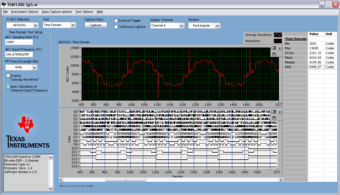

  • Richard/Aaron,
    Here are two captures of a 241MHz signal at 3dBm and 5dBm.  Something wrong appears to happen around the zero crossing of the signal (.. maybe inverted data?) and if I increase the amplitude to 5dBm, the signal gets even more distorted.
  • Hi - I'm working with Dan on the ADS42B49 eval....we did get the TSW1200 to work properly by setting
    Clock line Skew = 20.
    It had been 0 in the original file.  We did get a TSW1400 as well which is having some different problems - but I'll start a new thread for that.
    Thanks - Eric
    Hmmm. I'm glad you got it to work, but I have not had to do that with the ini file.   In case it helps shed any light on what that ini file setting means, attached is a sketch of how the ADC interface into the FPGA is implemented.  The Xilinx IDELAY cells are present on every LVDS input pair, and the IDELAY is essentially a tapped delay line with each delay increment equal to about 75ps.  The ini file for the EVM lets you set an IDELAY tap setting for the clock and another IDELAY tap setting for all of the data pairs.   Maybe adding enough skew to the clock is similar to inverting the clock.   Did you leave data line skew set to 10?   There is another ini file entry called Clock Edge, and if it is really that the clock is inverted somewhere in the path then setting this entry to =1 might be the better solution.   Delaying the clock might mean you need a different skew setting for slower sample rates due to longer clock period.  But if it works for what you are doing, maybe we don't want to monkey with it.

  • Ok - based on your comments, I think we modified more than just the Data line skew...I've copied in the timing portion of the file for reference.
    Max sample Rate=250E6
    Data format=Offset Binary
    Output format=Bit-wise DDR - 2 channel
    Clock Edge=0
    Data line skew=0
    Clock line Skew=20
    Hardware bit offset=0
