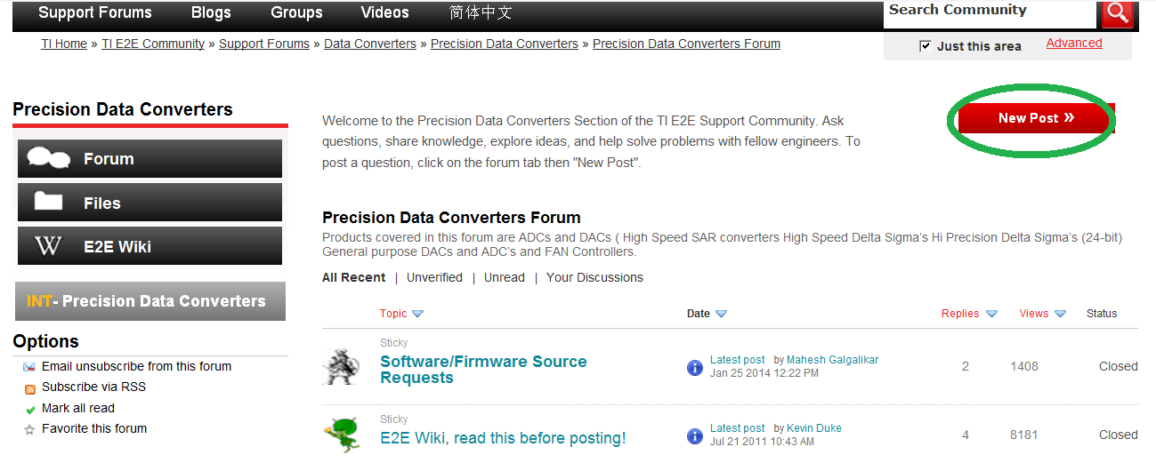

I have replied because there is no tab for new post.

    I've shown a picture below that shows how to create a new post.  You must go to the main forum page of the forum you wish to post in and then you will see the button for New Post in the upper right corner of the page.  I have circled it in green in the picture.
