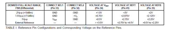

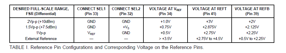

I am driving an ADS808 single ended with the other input set to 2.5VDC. I would like to know the min vrefb and the maximum vreft I can use with this part (ie what is the maximum input window when using the converter with external references).
