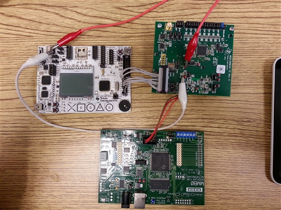

Greetings; I'm trying to get the ADS1299 working with the MSP430F5529. Right now i'm trying to do it with the ADS1299EEG-FE board without the MMB0 and the MSP-EXP430F5529. The power for the ADS1299 board and the MSP430 its from the MMB0 to ensure the DGND its share between the two boards. The MSP430 it's running at 25 Mhz.
For the communication i'm using the module USCI_B1:
- Pin 4.1 = SIMO
- Pin 4.2 = SOMI
- Pin 4.3 = CLK
The frequency on the USCI is 1 Mhz, this are the configuration registers on my program: 3-Wire SPI, 8 bit SPI Master, Clock idle state is LOW, MSB first, and the polarity - phase is as indicated in other posts, CKPH = 1, CKPL = 0.

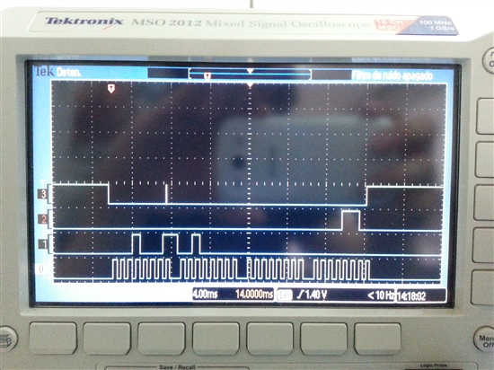

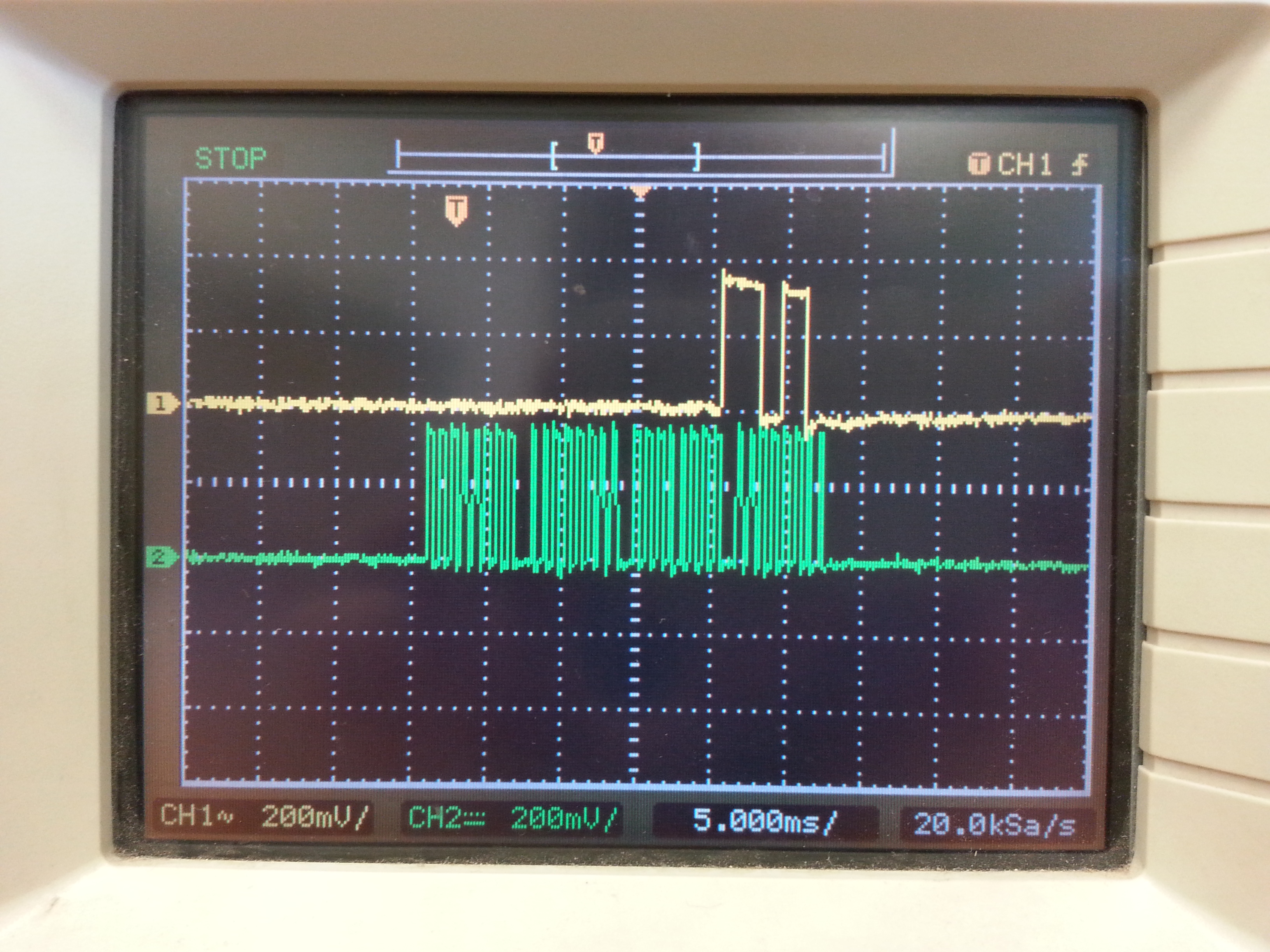

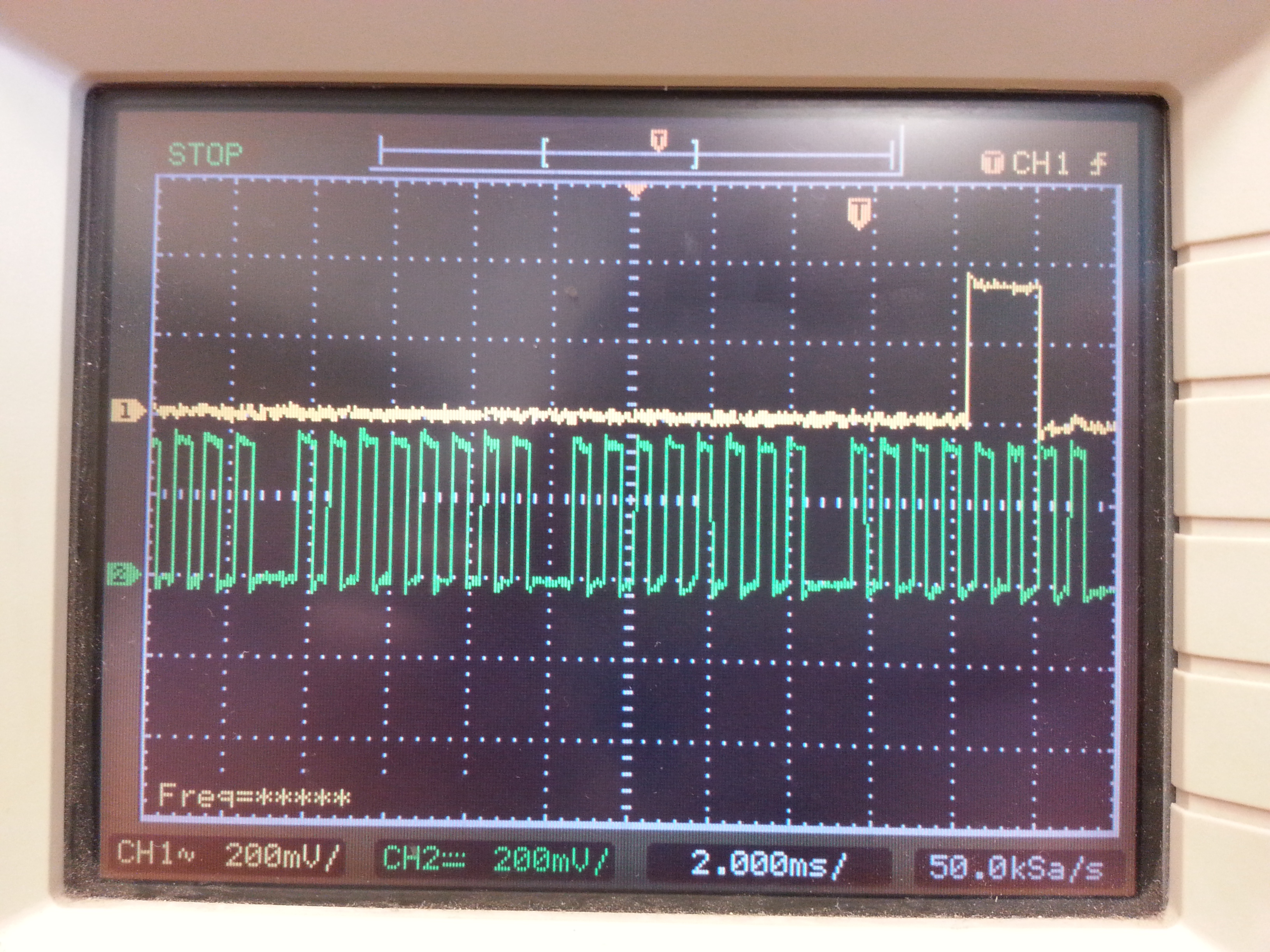

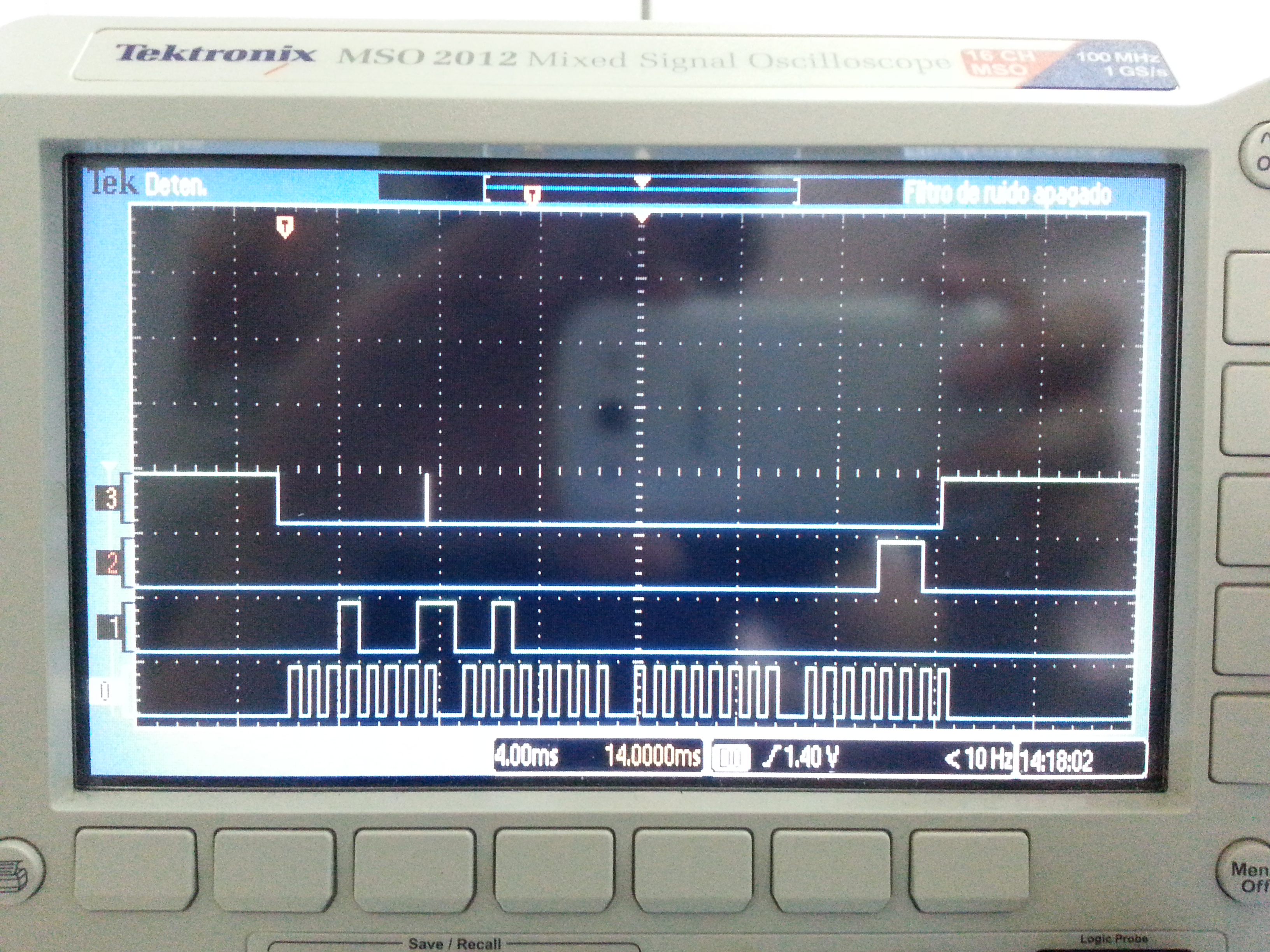

I know that you don't check the whole programming for every answer so i took some screenshots of the oscilloscope, every measure its done with the CLK from the SPI as reference that's because i just have two channels available and no Logic Analyzer.
So basically after the power up sequence if send the SDATAC command so i can read the ID register and that's it, here are the screenshots, the probes i'm using are 10x attenuated.
DOUT from EVM (ADS1299) = Yellow
SPI_CLK = Green
Same picture for more details:

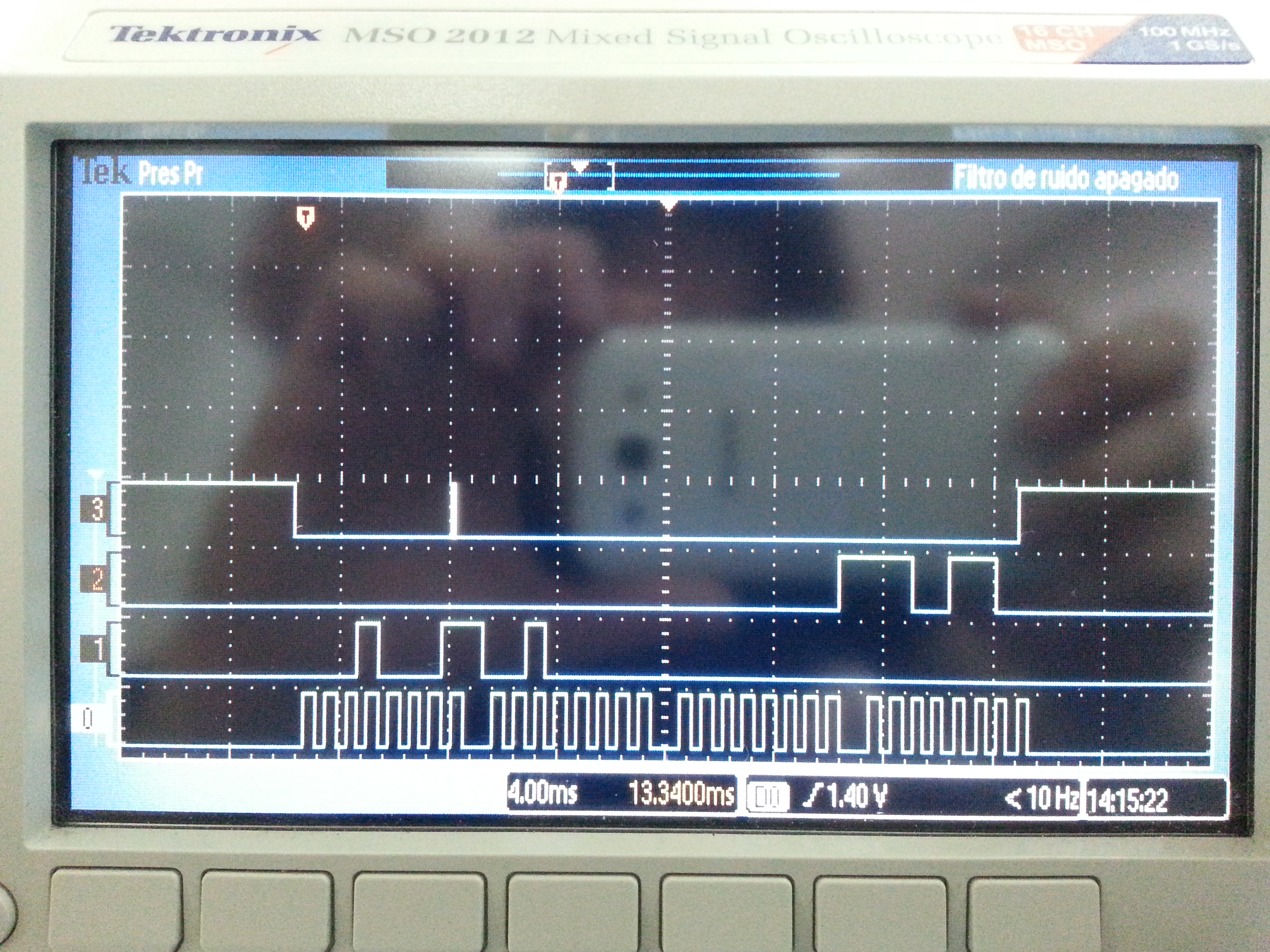

As you can see the code i'm getting from DOUT its not 0x1E as indicated on the datasheet, i checked the ID register value on the EVM software (0x3E), but even that value is not the one i think i get on DOUT (or maybe i'm wrong?).

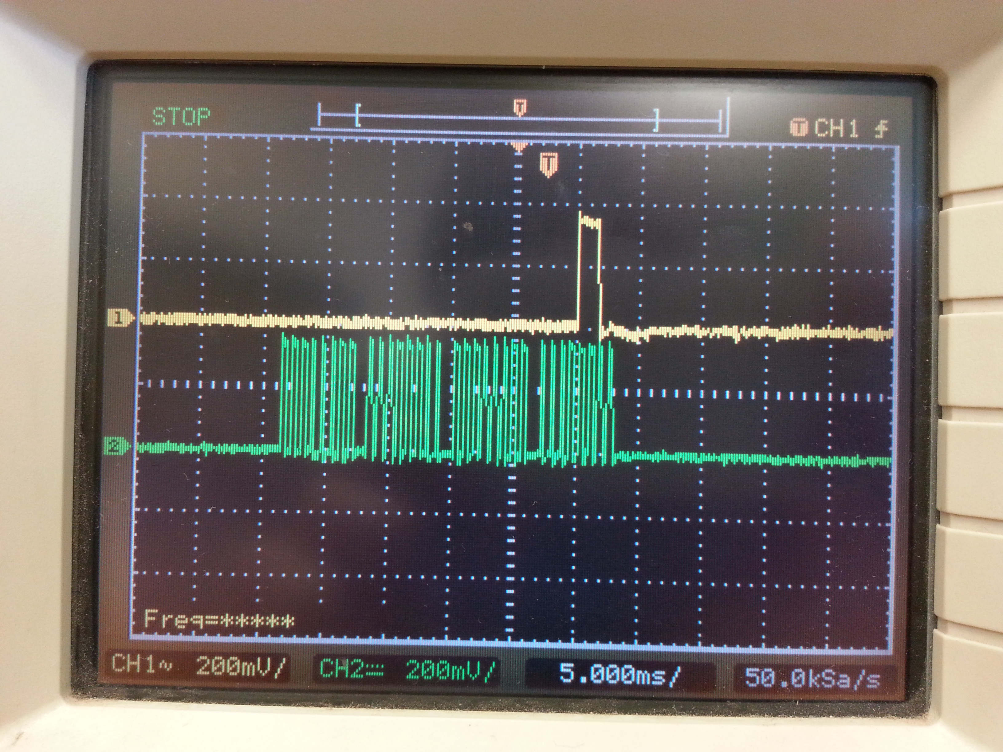

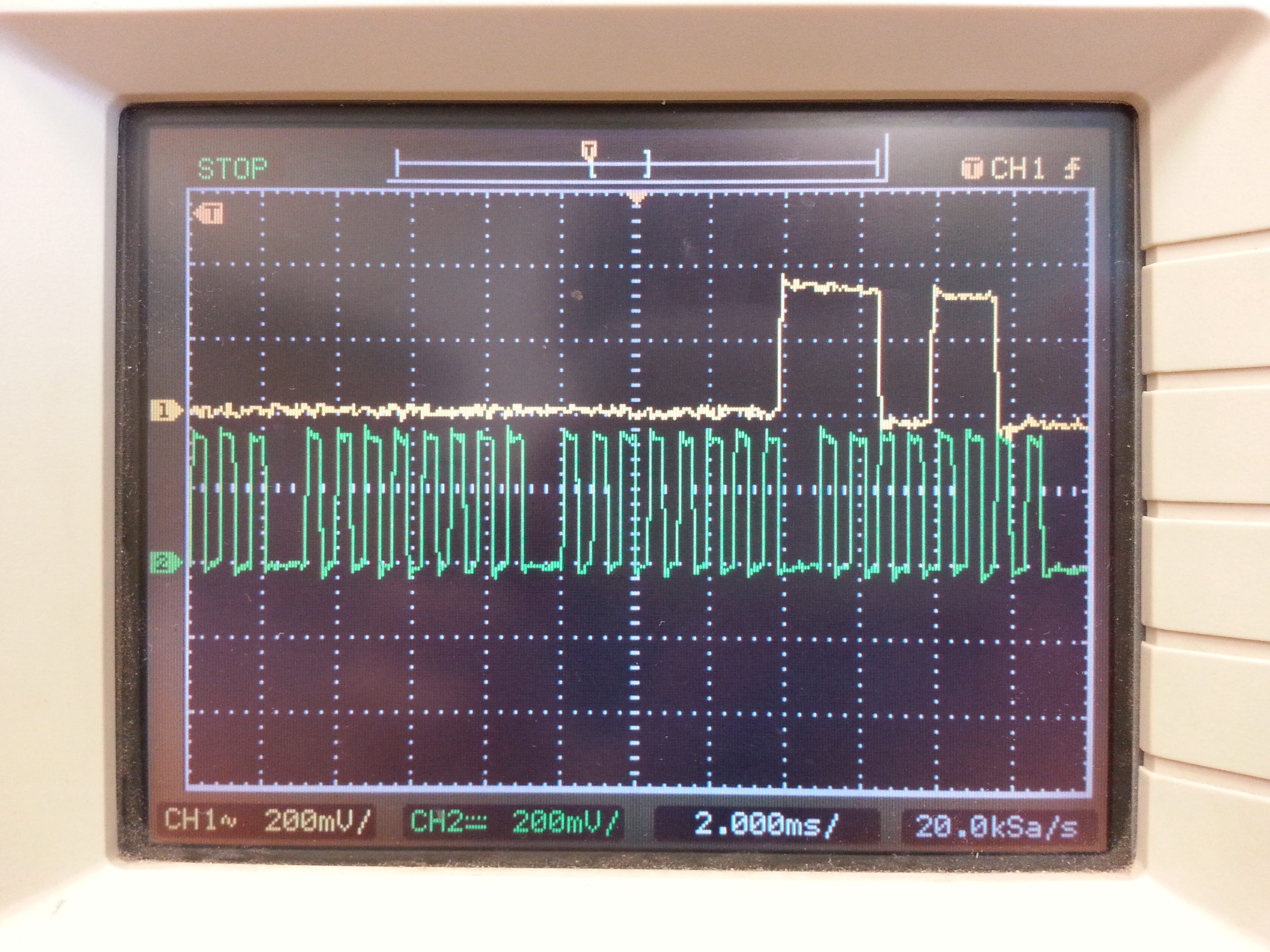

Sometimes i get this code from DOUT on the EVM:
SPI_CLK = Green

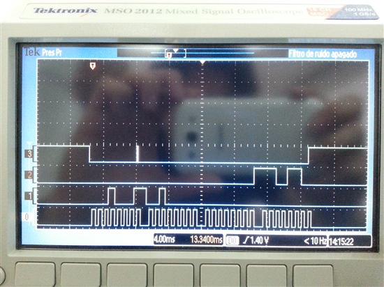

Same screenshot as before:

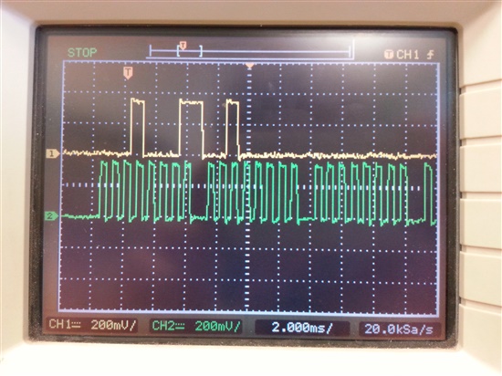

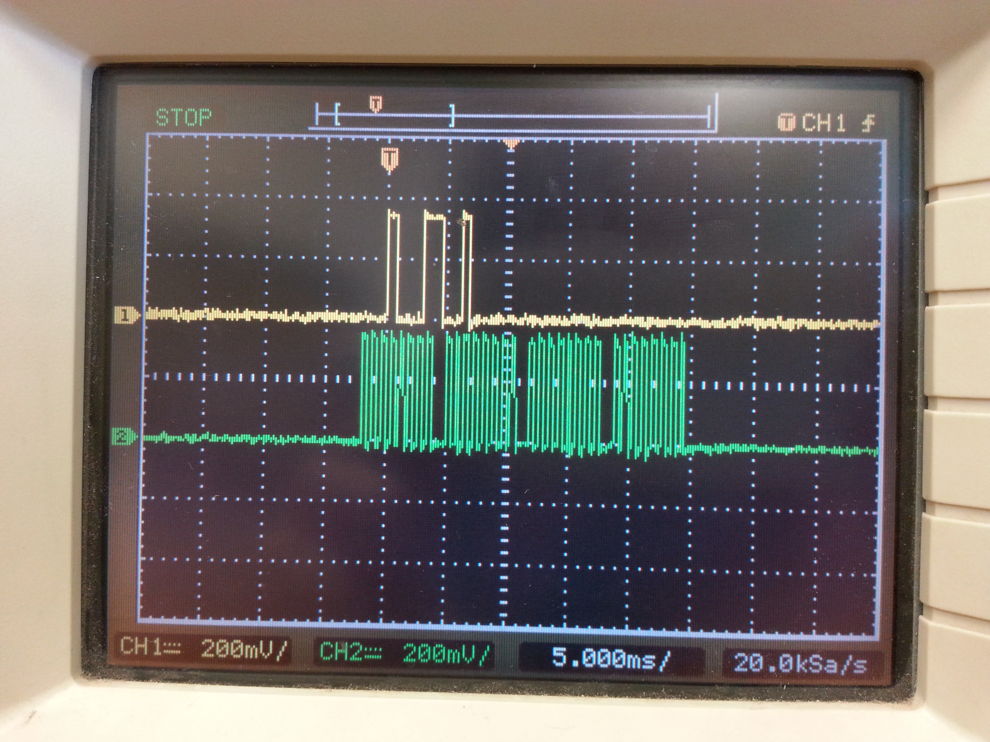

This is the value i'm sending to the EVM, i think its correct, still here is the screeshot:
DIN on the EVM (ADS1299) = Yellow
SPI_CLK = Green
Same screenshot:
Finally i add photos of my connections between boards:
The connections from J3 on the EVM goes to J5 on the MSP-EXP430F5529:

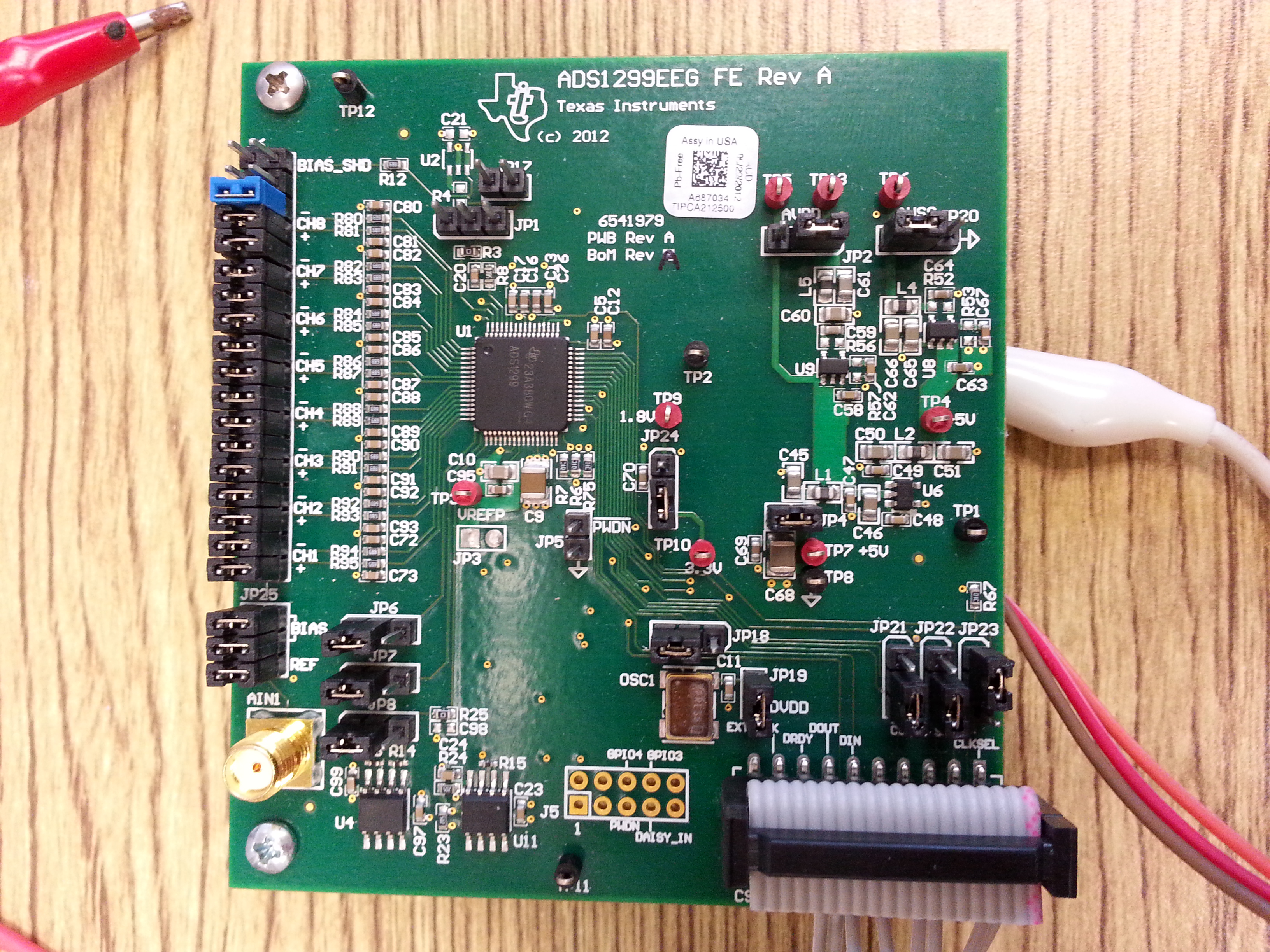

Here is a photo of the EVM so you can see my jumpers setup:
