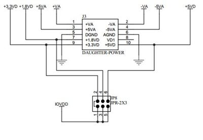

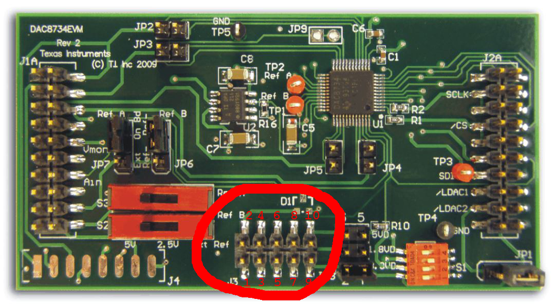

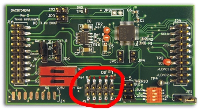

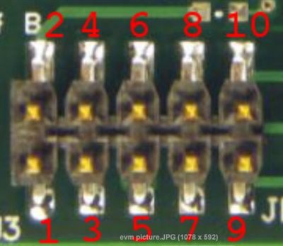

    Most of these power inputs are on the power block (J3) on the bottom center of the DAC8734EVM.
    • AVDD = J3[1] =+VA
    • AVSS = J3[2] = -VA
    • DVDD = J3[10] = +5VD
    • IOVDD has a jumper that allows you to select the voltage. The options are selected at JP8.
      • Option 1: JP8[1-2] = +3.3VD
      • Option 2: JP8[3-4] = +1.8VD
      • Option 3: JP8[5-6] = +5VD (Which is DVDD)
    • REF-A = S3 (You can choose +5V or +2.5V.)
      • If you want to supply your own reference set S3 to position 1 and supply your voltage reference at TP1.
    • REF-B = S2 (You can choose +5V or +2.5V.)
      • If you want to supply your own reference set S2 to position 1 and supply your voltage reference at TP2.
    • UNI/BIP-A = S1[4-5]
    • UNI/BIP-B = S1[2-7]
