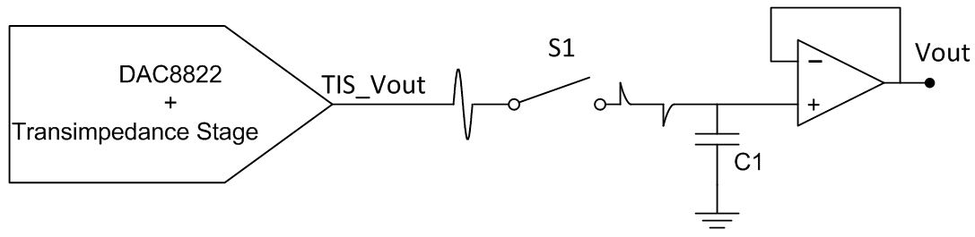

     A Sample and Hold circuit is another solution instead of the LPF. Since the DAC8822 outputs current, the S&H circuit should be ideally placed after the current to voltage conversion of the transimpedance stage.
     Take a look at the circuit below.
    The switch S1 is open during the glitch pulse, the previous DAC voltage level is maintained at Vout by the charge leftover at C1. After the glitch has settled, S1 closes and charges C1 with the new voltage.
    This is just a diagram of the circuit. The actual implementation which includes the control circuitry for detecting the glitch and controlling S1 is much more complex. The S&H circuit is not recommended unless absolutely necessary because it will increase the number of components and the footprint of the design.
    To summarize:
    The glitch specification refers to the energy of the impulse (area below the curve). The energy must be conserved according to the law of conservation of energy, therefore, the glitch energy has to be dissipated somewhere in the signal path. By adding a low pass filter, the energy is conserved and is spread out across a wider time frame, which reduces the amplitude. The only other alternative is to break the signal path. The S&H circuit accomplishes this but in doing so, lower energy glitches are appear when the switch opens and closes.
    I would suggest using the LPF and finding the compromise between an acceptable glitch amplitude and an acceptable settling time. Keep in mind that the worst glitch will typically occur at this midscale “major carry” transition (0x7FFF to 0x8000). “Major carry” refers to a code step in which all the switches inside the DAC change position; the switching action is what injects this energy into the signal path.

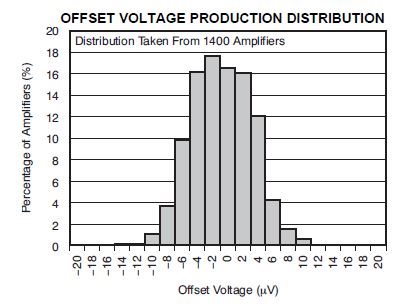

    However, they request distribution data like a inserting image again.
    I understand that sharing the distribution data which is undescription in the datasheet is difficult.
    However, if you have any distribution data of midscale Glitch voltage , please let me know.

  • Hello Asaka-san,
    Unfortunately there is no distribution data for glitch.
