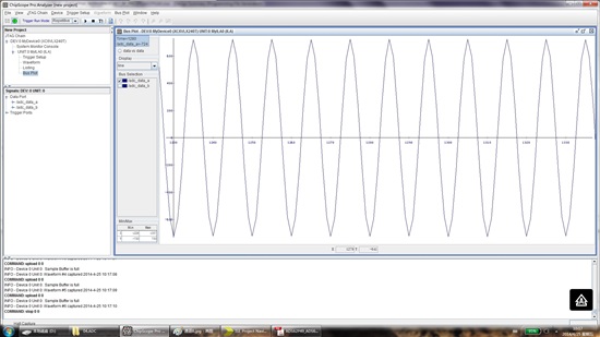

Now, I am using the ADS62P49.

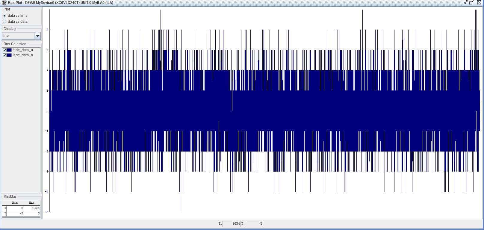

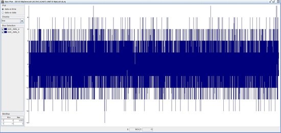

I find the input data of ADS62P49 is OK, only the OFFSET.
The input data of ADS62P49

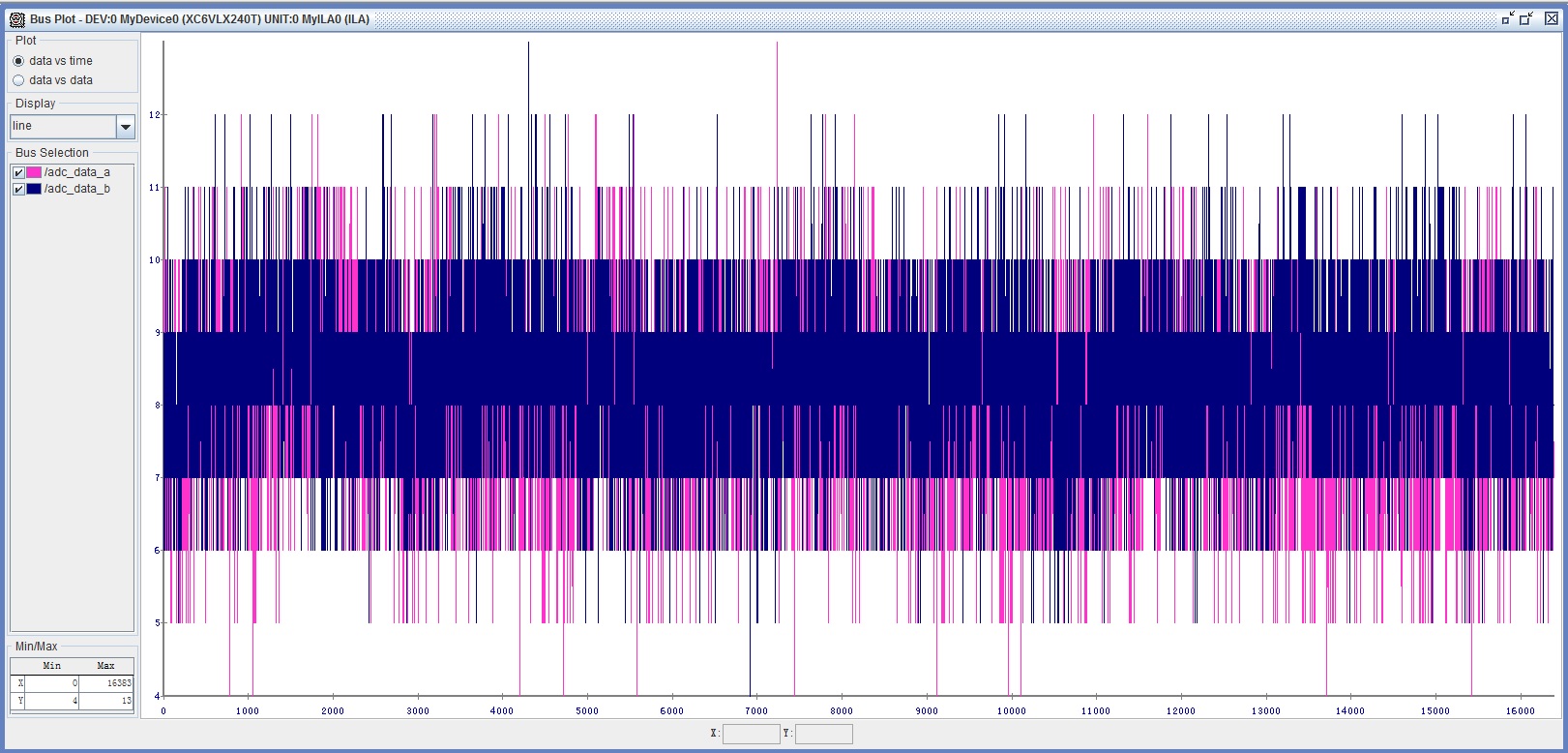

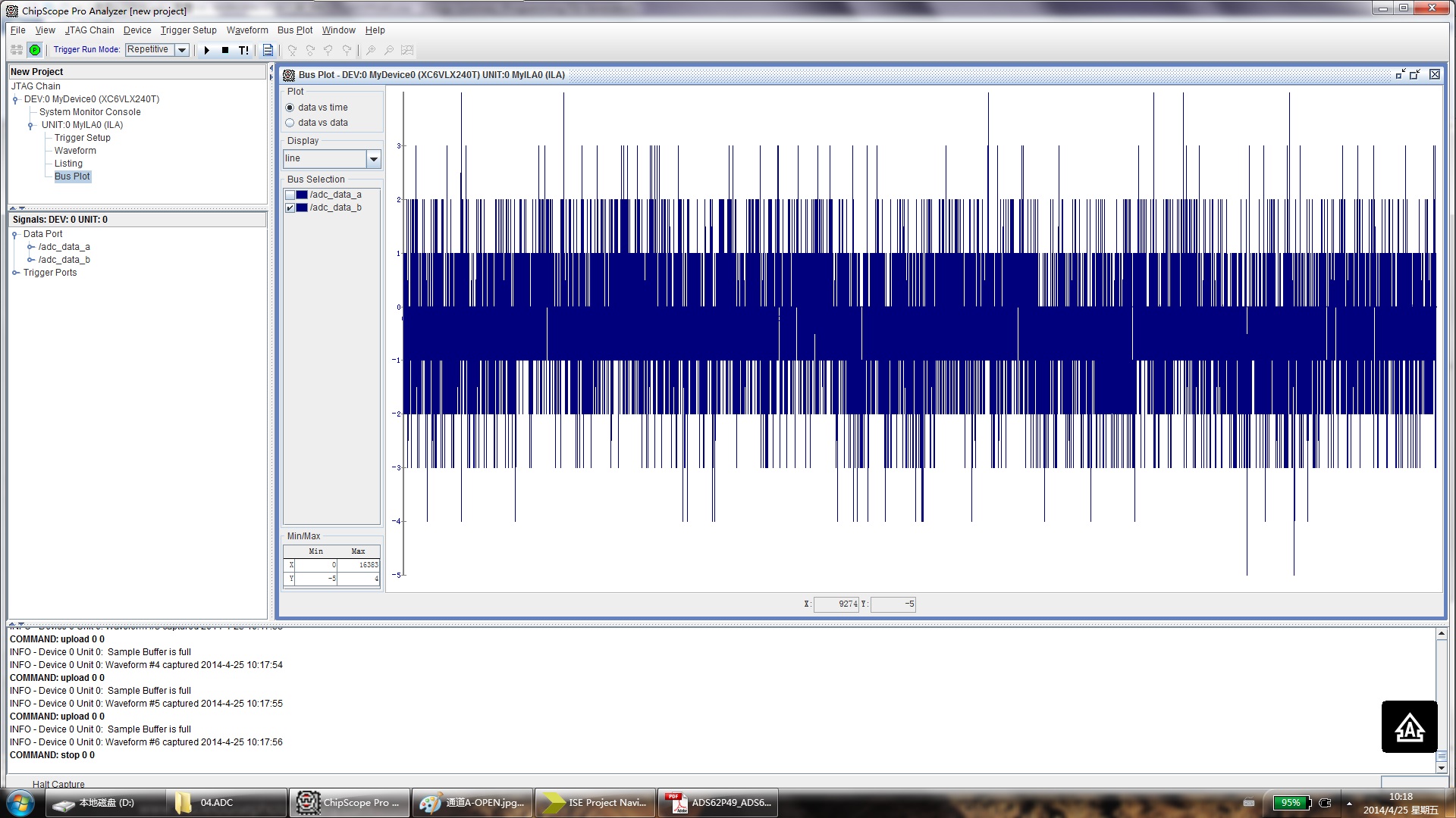

So, I enable the OFFSET CORRECTION by set the register 53 for 0x40.

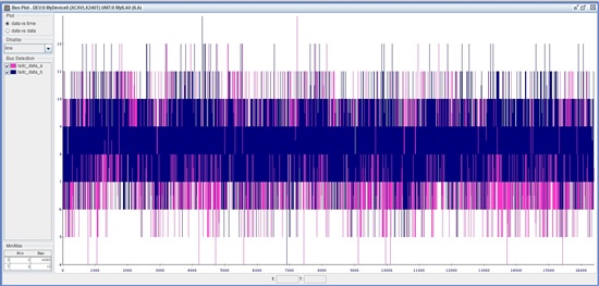

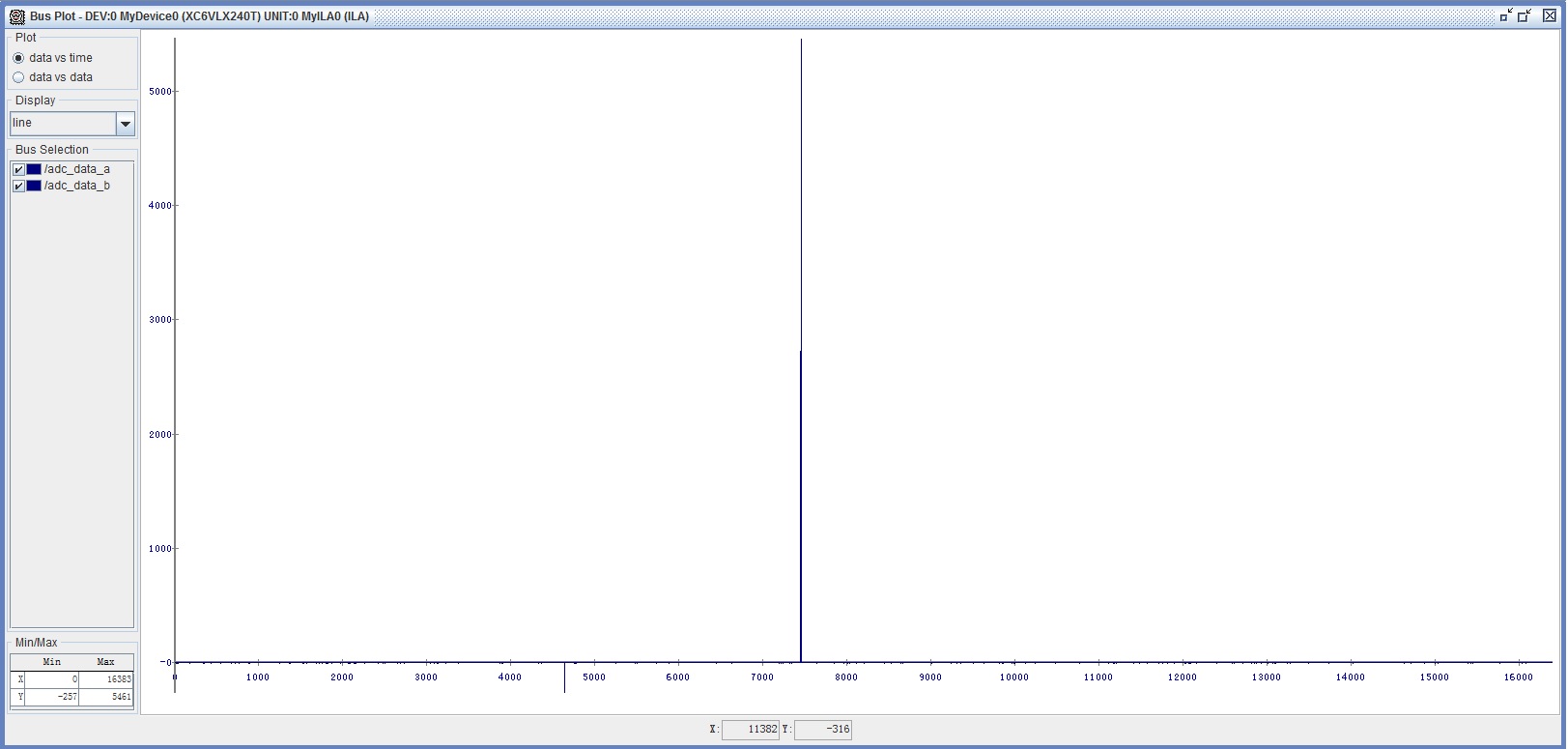

After do this, there is no OFFSET, but the input data appear burr sometimes.
The OFFSET is corrected
burr appear after Enable OFFSET correct
