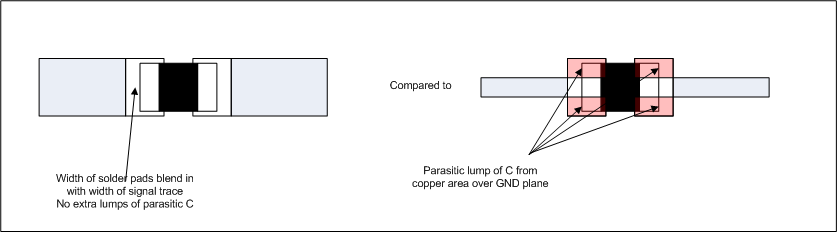

I'm wondering about some specific layout techniques on the ADS5400 EVM. The transmission lines from the input jack to the baluns (T4, T5) seem to be Grounded Coplanar Waveguides - O.K. What I'm wondering about is the Waveguide structure from balun#2 (T5) to the ADS5400 Chip. Obviously it's a differential pair line structure with a 100Ohm resistor at the end - but it's not a common differential pair layout (like all the other 100 Ohm LVDS lines) but there seems to be combination of Differential pair line and grounded coplanar structure.
My question is why is there a coplanar grounded differential structure (instead of a common 100Ohm differential pair structure, which would allow the transmission lines to be much smaller in their width)??
I'm very curious about this layout and I hope that someone can answer my question,
M. Krist

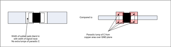

    The signal traces from the SMA input J1 (and from the optional SMA J2 if a differential input is used and the baluns bypassed) are by necessity single ended controlled impedance because the components themselves (such as the SMA connectors, zer-ohm jumper resistors, baluns or transformers and AC coupling caps) are too bulky to let us tightly couple the traces. But after all the optional components on the input circuitry we are able to tightly couple the trace from R25/26 to form a differential controlled impedance path up to the ADC.  In both cases, however, we notched out the layer2 ground plane under the input circuitry and referenced to a ground plane on layer three so that we *could* make the traces wider.  We did this so that the solder pads for the various components could 'blend in' with the width of the signal trace instead of having a large solder pad relative to the width of the trace.  This was to reduce the lumps of parasitic capacitance to ground at each of the solder points since we have so many solder options available for the input circuit.  We can't do much about the size of the solder pads, but we can size up the trace by playing with the layer stackup to match signal to solder pad.

    I took a look at the design database with one of our board layout people.  The differential trace in question is a 10-mil wide trace with a 6-mil spacing between the trace.  (And with the ground plane on layer 2 below notched away the actual ground reference below is on layer three, which is a 5mil pre-preg plus 6mil pre-preg away.)  These values were chosen to give a 100 ohm differential impedance.  The ground plane on the top layer on either side of the pair is spaced at 30-mil away.  So i would not call this coplanar.  A general rule of thumb is that something that is 3-W away is not tightly coupled, and with the width W=10mil i can see where the spacing out to the ground pour on the top was set to be 30mil to be 3W.
    I also note that the LVDS pairs are to be 100 ohm, and the board stackup calls for them to be 4-mil width with 6-mil spacing and the ground plane below is on layer 2.  The original revision of the EVM also had the tightly coupled portion of the analog input set to use the same trace width and space as the LVDS, but when we notched out the ground plane under the analog inputs then the dimensions of the analog path increased throughout, which was the intent.
