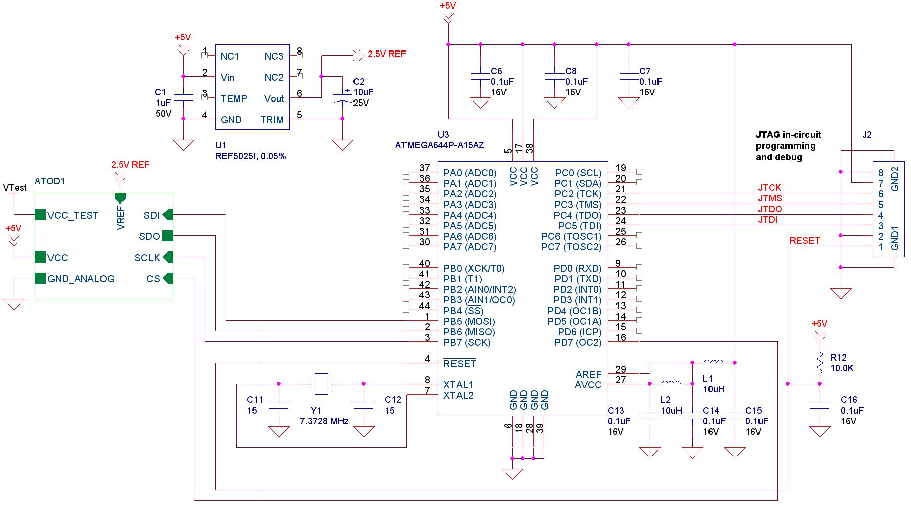

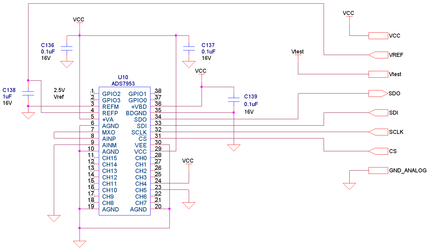

I built a small pcb with an ADS7953 and an AVR microcontroller for measuring DC voltage levels.  Vcc = 5V, Vref = 2.5V, AINP is directly connected to MXO, the processor is running at 7.3728MHz. (140nS per clock).  I currently have channel 4 connected to 5V, channel 5 connected to 0V, all other channels float.  I am bit-banging the serial communication and posted the source code below.   I'm using manual mode with Range2 and read all 16 channels in a continuous loop.   In debug mode, I pause the code and use the watch window to view the current samples which are stored in an array.

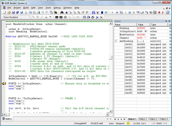

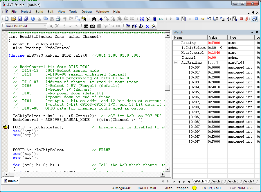

When I read from channel 4, I currently see 0x401C.  I would expect to read 0x4FFF for a full-scale measurement.  When I read channel 5 (or any of the floating channels)  I get 0x5000, 0x6000, 0x7000, etc.  While these values are incorrect, I see the channel number so I think my read/write is working correctly.
When I add some 1 second delays between frames, channel 4 will only get as high as 0x402F.  I never get close to 0x4FFF!  Also, with delays I start to read values from the grounded and floating channels such as 0x501F, 0x6020, 0x701A, etc.

    Could you send me a schematic of the ADC potion of your ADC to AVR hook up and possibly a screen capture of your communication interface? The code is a good start, I might be able to port that to one of my (TI) processors, but it would be a quicker resolution to see a screen shot if you can get one.
  • Hi Tom,
    Thanks for your response.  Here are the requested  screen captures.
     Schematic Page 1
    Schematic Page 2
    AVR Studio Debug Window

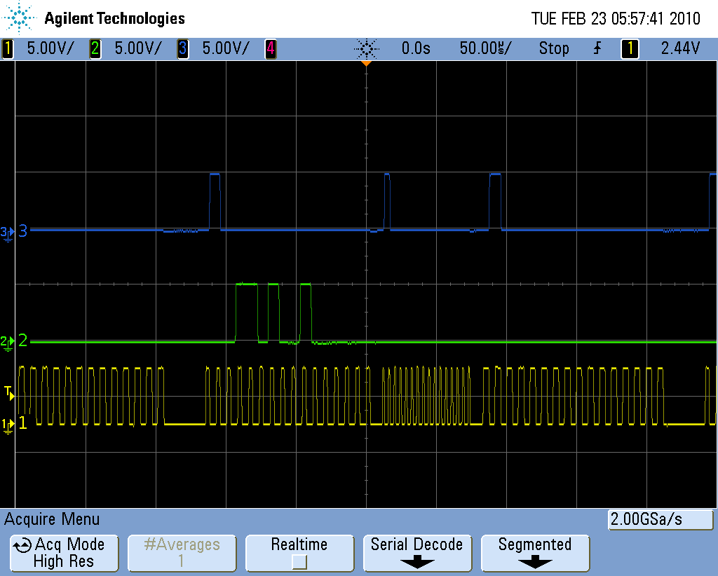

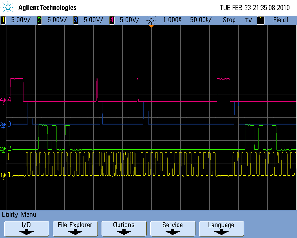

  • Thanks Gordo - can you grab a screen shot of the SPI communication to the ADC?  Scope traces showing the SCLK, SDO, SDI and /CS?
  • Hi Tom,
    Please see below: yellow = clk, green=SDI, blue = SDO.
    My program is running in a loop reading in manual mode from channel 4 which is tied to VCC.  The read begins after the ~30uS delay.  The first frame programs the part, the second frame is 16 clocks but no read/write occurs.  In the third frame I actually read the data from the SDO line.
    Thanks again for your help.

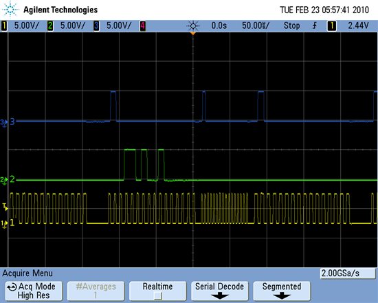

  • Hi Tom,
    Here it is again with chip select added (red).  These scope traces are the result of letting the code run in a loop and then freezing the scope.  As you can see, I read 0x000.  When I step through the entire sequence, I read some 12-bit values, but not close to 0xFFF as I would expect for a channel that is tied to VCC.
  • Hummm...
    Hate to say it but I am stumped at the moment.  The SDI looks correct - manual mode, select CH4, etc.  The SDO is certainly 'zero'.  I'll assume you've double checked all the voltages (power, reference) and control connections on your board.  Let me see what I can do about getting you one of our EVM's to play with...

    I found my problem.  Of course it was a stupid thing...
    On my first attempt at getting the circuit to work, my resistor dividers were not correct - so I was placing a high voltage on the input channels.  I corrected those, and assuming I damaged the chip, I replaced that as well.  When I replaced the chip, I broke the trace between the MUX output and the AINP pin.   Now it works as expected.
