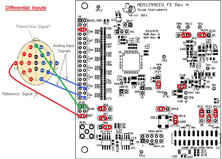

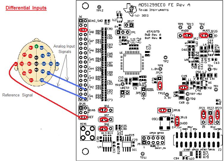

I've been trying to initialize ADS1299 EVM in DIFFERENTIAL INPUTS mode, but I dont understand why it doesnt work.
1.-INP is the positive input of the normal electrode(CH1+, CH2+), but where is connected INN (-)? Is not connected?. In software I out "normal electrodes"
2.- I think that I need to be operated with a bipolar supply, therefore JP2=1-2, JP20=2-3.
3.- As I use reference signal. Set the SRB1 bit in the MISC1 register to route the SRB1 pin to the negative in software.
4.- all of them software I used at defautl.
    When you set SRB1 = 1, the external INN pins are not connected to the PGA inside the ADS1299. Instead, the signal on SRB1 is routed internally to PGAN (see Figure 19 for Input Multiplexer block diagram). In your setup, you are driving SRB1 with your reference electrode, which should be fine for single-ended EEG measurements.
    Have you tried buffering your reference electrode through U4? To do this, change JP8 to [2-3].
    If you need me to look over your register settings, I will gladly do so.

    Do you mind I keep SRB1 Bridge (JP25 5-6) and change JP8 (2-3)?
    and the others jumpers are ok?
    In the software ¿Do I need to make any change?
    I ve device defaults, just set SRB1 close...  do I need to change it closed again?
    Gracias por ayudarme.

  • With JP25 [5-6] connected, BIAS_ELEC and REF_ELEC will be shorted together. Was this your intention?
    Because JP6 = [1-2], the BIAS_ELEC signal is simply a mid-supply voltage buffered by U11. This would equal 0V because you are using dual-supplies (+/- 2.5V).
    In contrast, the REF_ELEC will carry some DC bias and some local EEG AC signal (assuming you still drive the patient).
    I'm not sure which option is best for your single-ended measurements: INxN = BIAS_ELEC (mid-supply), or INxN = REF_ELEC (DC+EEG). I would experiment with removing JP25[5-6] and use REF_ELEC as your SRB1 input. Connect the reference electrode to JP25[6] only. To buffer the REF_ELEC signal and give it better drive capability, use JP7[1-2] and JP8[2-3].
    Lastly, you can always confirm your register settings using the ADC Register tab -> Register Map -> Refresh Registers.
    Saludos!

    In order to reduce noise, I want (tried) to do in DIFFERENTIAL INPUTS (not single ended). I followed 4.6.1, so I change the JP2(1-2), JP20(2-3),JP6 (5-6) jumpers.
    According to what I understood from the users guide (section 7) ADS1299 EVM has dedicated electrodes (BIAS_ELEC, REF_ELEC) and I can use both in the same time...  I dont understand that is through JP25 or through software.
    for your advice, I have changed the JP8 (2-3) and REF_ELEC to JP25 (6)  and remove JP6(1-2).. but to be differentially, I need ... BIAS_ELEC in order to comparate 2 active channels.
    Gracias de nuevo
    Norma
