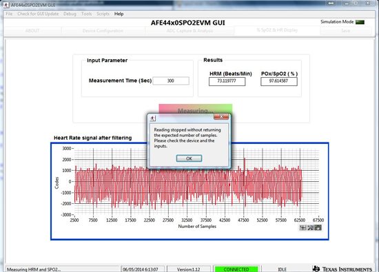

I got an error message when recording more than 4 minutes of data. It seems that something crashes in the communication protocol. I would like to learn what causes the problem.
The %SpO2 & HR Display tab cannot capture more than 2 minutes of data.
%SpO2 & HR algorithm implemented is not accurate. So we do not plan to support this mode of operation in the newer version of the GUI.
