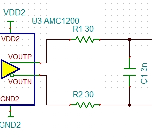

  • Hello Varaprasad,
    I notice that you are using 150nF capacitor after AMC1200, there is no way for AMC1200 to drive such big capacitor directly, suggest to use 30 ohm resistor, 3nF capacitor RC filter which cutoff frequency is about 880kHz. this will help to keep you away from distortion.

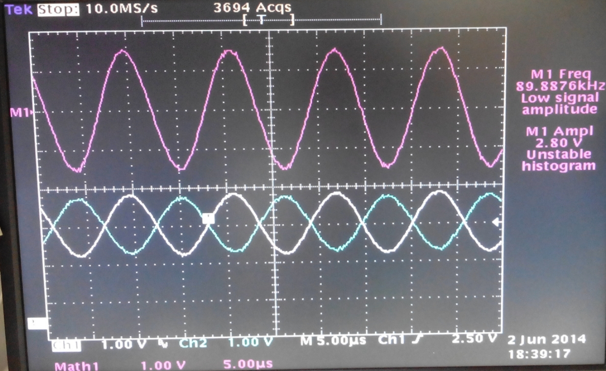

  • Hello Varaprasad,
    Since you are not connect the grounds of AMC and TIVA together, it's possible that there are some commom mode voltage exsist between these two grounds, which will lead to big current flow between these two parts, especially you have not connected any resistor between them.Thus suggest to tie these two ground together, which will help to provide stable common mode voltage of the differential signal between these two parts.
    I have tested AMC1200 with the RC filter shown in ''CIRCUIT 2" of latest attached file, the amplitude attenuation is obvious, but I have not see many distortation, shown as following (input 500mVpp, 90Hz):
    I think the distortation you experiencing is caused by the measurement method, since it's a true-differential output, It's better to use ture-differential probe in the measurment, or to use two channels in the oscilloscope to measure each output line, then use the math function inside the oscilloscope to get the result, especially when you have connected the neutral line of DC power supply and oscilloscope to the same neutral line.
    About the output filter, it's better to use a smaller common mode capacitor and connect it after the resistor as following:
