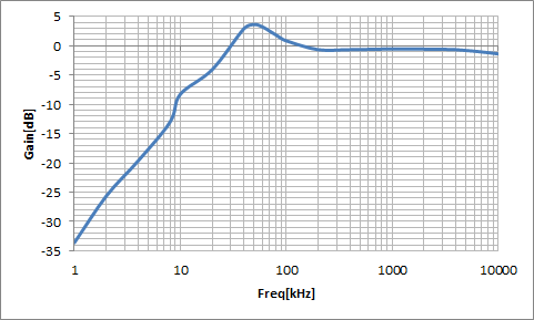

Hi all,
According to the overview of VCA2618 datasheet of page 9,
" By using the internal coupling into the PGA,
  the result is a high-pass filter characteristic with cutoff at
  approximately 75kHz. The output PGA naturally rolls off at
  around 30MHz, making the usable bandwidth of the VCA2618
  between 75kHz and 30MHz."
However  the section of PGA post filter of page 11 described that
 "The lowfrequency bandwidth is set by the following equation:
   1/(2 •π • 500kΩ• (220pF + CEXTERNAL))"
And when CEXTERNAL is 0(pF), the result is about 1.447kHz.
The result is not 75kHz.
 Why is the calculation result not 75kHz?
