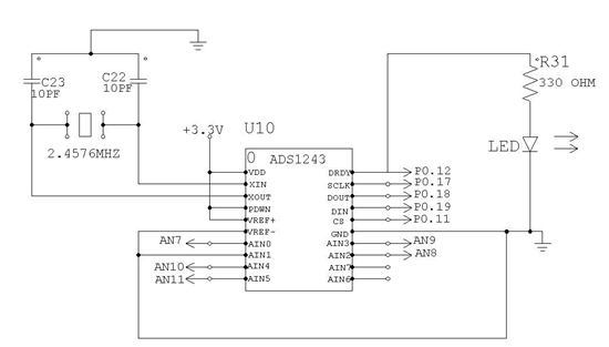

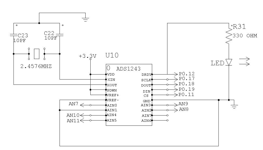

  • Hi Bob,
    Sorry for the late communication. I was held up in another
    project. My guys started getting results from ADS1243.
    I am getting 0 and full reading for 0V and 3.3V analog input.
    I have connected as follows
    VDD, VREF+ 3.3
    VREF- Gnd
    AIN1 : GND
    Register settings
    ACR 0x44 (i.e)
    UNIPOLAR
    RANGE=1
    all other registers are to default.
    I am using LPC2148 as controller MC crystal is 12Mhz
    I am attaching the schematic

  • Hi Clarence,
    From your previous schematic you show AIN7 as not connected.  Do you have a sensor/voltage connected to AIN7?
    Bob B
  • Hi Bob,
    Thanks for your reply. Yes, I have connected 30K Thermistor. I am using two(2) ADS1243 the schematic is for the second IC.
    Clarence
  • Hi Clarence,
    Unfortunately your are providing very little information as to your problem.  For me to be of much help I need some more detail as to exactly what you have connected (detailed schematic) and what is being applied to the inputs as well as the data results you are seeing from the ADC (raw codes).
    It is possible that you are changing your mux too late to receive a valid conversion result.  If you take a look at diagram 2 on page 6 of the ADS1243 datasheet you will see a time t17.  Following the falling edge of DRDY you have only this window of time for changing the mux to allow enough sampling data to pass through the digital filter for single-cycle settling.  Beyond this region of time you will mix sampling from the previous mux setting with the new mux setting which will give an invalid response.  If you cannot change the mux within this window of time, then you will need to discard the first result after the mux change or use the DSYNC command to reset the digital filter.
    You can find more information on page 10 in Figure 2 and the discussion on Input Multiplexer.  You can reset the digital filter to restart conversion using the DSYNC command.  The DSYNC Operation is discussed on page 14.
