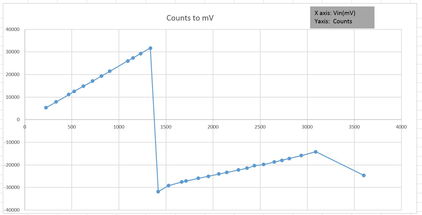

ADS 1178: transfer function question
Hi
I was testing a Data acquisition system based on 1178.I plotted voltage to count output and found this graph
Test condition: Vrefp: 2.5V, Vrefn=0, Avdd=5V IOVdd=3.3V DVdd= 1.8V
Sampling rate=20khz.
All input voltage is centered at 2.5V. What would be the reason I am getting that saturation and flipping to the negative half? Is it some thing related to my amplifier output?
regards
niranjan
