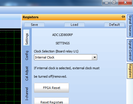

    One more thing to try. In the WaveVision5 GUI, navigate to the "Registers" tab on the right side (shown below).
    Toggle the Clock Selection to "External Clock" then back to "Internal Clock". There could potentially be a timing issue that is marginal in the FPGA code. If this solves the problem, then you will likely need to add some delay in the code to allow the clock to be properly and full programmed before advancing.

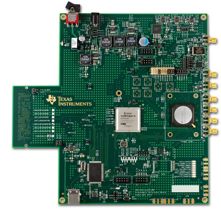

    5 Here we would like to give you the picture of our bord :

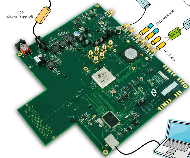

    7.  we have also watch the demo vedio on the website http://www.ti.com/tool/adc12d800rfrb.we foud tha the board is a litte different of ours.The logo is NS, but not TI. It looks like as the following:
    8 also on the website metioned in 7 ,there is  a  ADC12D800RFRB Design Package  we downlowd it ,finding the schematic is not matched with our board. So,we are very  puzzled by the version of board、 software、FPGA image、and design package.
    9 For one more thing ,why the number on the on board clock PLL is VM AB24E3 4123203 but not LM2531 or LM2541.?We googled the number but found nothing.

    To convert the topside marking on the Clock IC, you can use the part mart lookup tool: http://www.ti.com/general/docs/partmarking/partmarkinghome.jsp
    The device that is on the board is the LMX2541SQ3320E which has a topside marking of 413320E

    To the original question, have you tried toggling the "Clock Selection" in the WaveVision GUI as mentioned above?

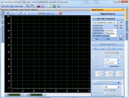

          I had tried toggling the "Clock Selection" in the WaveVision GUI,sorry for forgetting to inform you in the last reply. But the DCLK is also not detected by FPGA. And the sampling rate display on the WV5 is like this(32kHz??):

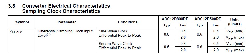

        Oh, one important thing is: we had doubt the if the amplitude of the differential clock is not enough or is not normal ,because we had tested  the CLK+ is -10dBm and the CLK- is -6.6dBm.And the data sheet of ADC says the min peak to peak voltage of the VIN_CLK is 0.4V(we calculate it as -4dBm, you can have a check.)  like the following, With your experiences , is this input clock  normal or unnormal??

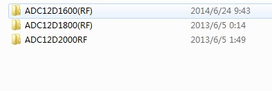

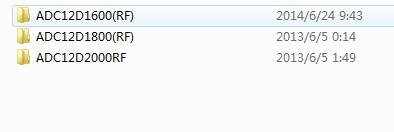

        For one thing,   in the designed packege , there is a FPGA Source folder it is like this(there is no 800RF??):
    and the ISE project in these three folder can not be opened warning there are missing files.

    The ADC12D800RFRB3 uses the same schematics and layouts as the design package above. Thank you for pointing out the absence of FPGA source code, which I have attached below:
    3122.ADC12D800RFRB.zip
    For the clock amplitude, we specify a limit 0.4Vpp (-7dBm into 100Ω differential load). Since the clock receiver is detecting the zero crossing we expect that it will work below this level, but noise/jitter starts to have an impact on performance so we cannot recommend reliable operation.
    However, if the board has not been modified then it is unlikely that clock amplitude is the problem. All of the boards we release have been checked for functionality and performance so we would be very surprised to see a hardware failure.
    As one more check, when you toggle the "Clock Selection" from external back to internal, the "Sampling Rate" may not update until you take a capture. Can you try a capture event and let us know if it still has a time out error?

    We actually have tried many times capturing a data no matter before or after toggling the Clock Selection. When using the on borad clock , it is a time out error ,when using  a externla clock output by a RS signal generator , the WV5 warned the DUT can't detecte a clock.
