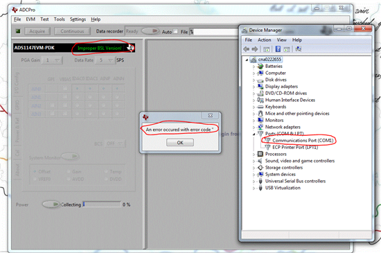

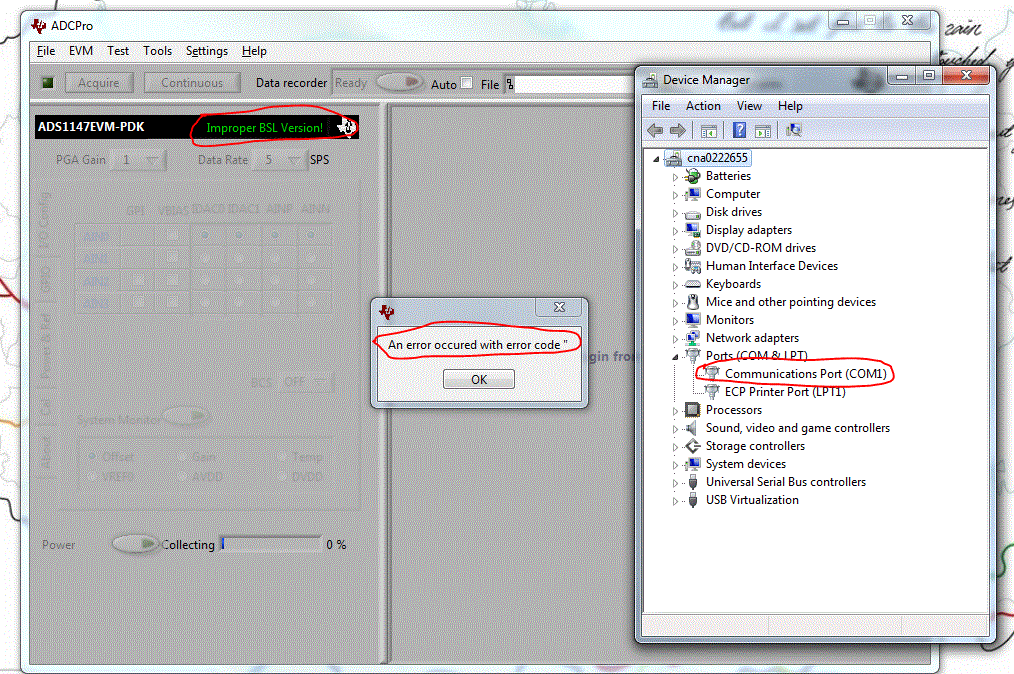

I have the new plugin of ADS1147 and the driver is correctly installed.
1. Install ADC pro and EVM plugin (and the driver)
2. Connect the ADS1248EVM to the MMB3 and the SW4 of the MMB3 in the right position
3. Connect the MMB3 to my PC via USB (BRD TEST message appears)
4. Start ADC Pro
5. Load ADS1147 EVM plugin
6. The software find the MMB3 and the message "Switch to the BSL position then press ok" appears
7. I switch to the BSL position (BRD TEST message disapears)
8. I press ok
9. "An error occured with error code" " or "improper BSL version !" message
Could someone help on this issue?
Thank you.

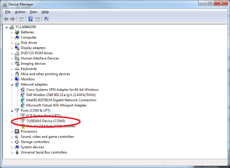

  • Hi Na,
    The TUSB3410 device drivers do not appear to be loaded.  Reinstall the plugin (making sure that the MMB3 is not plugged into the computer).  Each time the plugin is run it will either install or uninstall the drivers based on any previous install.  When the drivers are properly installed and the MMB3 is plugged in you should see something like the following:
    Also make sure that the proper board is installed on the EVM for the firmware you are trying to load.  At one point you mentioned the ADS1248 and are showing the ADS1147 plugin.
    Bob B
  • Dear Bob,
    Thank you for helping.
    When I installed the PKD, the MMB was connected to my PC, which leaded the  TUSB3410 device drivers did not well installed. Thank you.
    Best regards
    Na
