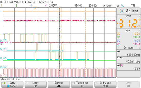

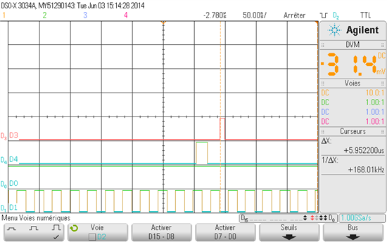

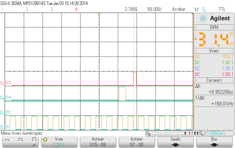

My config use 2 ADS8319, I met 2 issues type, not all parts are concerned, only some time to time (about 20%):
1) busy indicator in first position in daisy chaine is not at the correct place related to clk (it appear at low level of clk between falling edge and rising edge clk - any other clock are present in the design) (see D3 on next picture
info:
D1 = Clk, D3 = SDO (1st part)
2) the number of bit transfered from the first part to the second one is greater than the 16 bits expected (1 more bit) so all conversions are  improperly read (see next picture - Busy indicator of 1st part seems to be read as data by the 2nd part !!)
Other info:
D1 = Clk, D5 = SDO of first part, D4 = SDO of 2nd Part
Fclk = 35MHz Fsmpl = 100KSmpl/S,
Schematic is based on  datasheet application (ADS8319 P 18)
Those issues, when append, are present on all frames all time (not a glitch or aleas).
by exchanging part issue is (are) solved.
Do you have some advice or track to understand that and correct it.
Thank you in advance
Alain

    Your first question is now clear and is not a cause of concern. As mentioned in page 13 of the datasheet, the ADS8319 does has an internal (interface independent) clock that is used to run the conversions. The busy indicator can go high between 1.1-1.4us after the rise edge of CNV based on this internal clock and does not derive its timing from the SCLK of the SPI interface.
    The second question looks like a timing issue. Could you please elaborate on “by exchanging part issue is solved” – are you replacing one/both of the devices or are you interchanging the order of devices on the daisy chain?

    I fact first point is not yet solved. I agree with you about delay time between start of conversion and rising edge of busy indicator. However Busy in,dicator is build to be read from SDI at falling edge of clk. You could observe it fall down before it can be read! so busy indicator function is unavailable in this case.

    There is a window of uncertainty to when the busy signal would be driven high and this number can show part to part variation. With a free running SCLK as you have used in your implementation, there is a possibility of missing the BUSY signal with some parts.
    The intended method to use the “Daisy Chain Mode with Busy Indicator” mode, as shown in Fig. 55 of the datasheet, is to use the SDO of the closest ADC as a interrupt (IRQ) to the host. Only after the IRQ is received, should the host start driving the required number of SCLK edges to the device to read the conversion results.
    Also in order to correctly configure the devices to generate the Busy Indicator at the end of conversion, it is necessary that SCLK is high at the rising edge of CONVST (it might be a bit tricky to ensure this condition with a free running SCLK). CONVST must continue to remain high from the start of the conversion until all of the data bits are read. Hope you have taken care of these conditions in your design.
    I would recommend that you move your implementation from a continuously running interface clock to a bursty SCLK generated when the devices indicate that data is available.

    The 2nd issue is most likely a marginality in the capture timing. The fact that it varies from part to part also points to this. You should try running the design at a much slower clock speed to confirm. With the marginality removed, it should be easy to pick the location of the bits to be captured.
