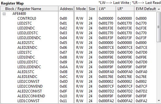

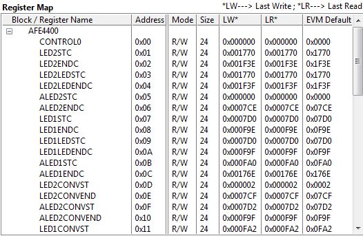

  • Thanks Atul for the information.
    The AFE4400 GUI has the following register map but
    Can someone suggest me flow of steps(address and commands ) that are needed
    1)if only the heart rate signal is to be read using the serial communication from Labview,
    2)Timing information (like the waiting time after sending each "Write Register Command")
    3) also what is the difference between LED2STC [15:0] and LED2LEDSTC[15:0].
    4) What baudrate should be used for the serial communication.
    Thanks.
    I have not implemented this on LABVIEW but I am sure you can implement on any software with serial communication.
    Regarding your queries:
    1. If you just want to read the heart rate signals, you don't need to change any register settings. Just send the ADCREAD command in the communication protocol.
    Eg. To implement a nearly continuous reading send 0x01 0x2A 0xFF 0xFF 0xFF 0xFF 0xFF 0x0D
    2. There is no waiting time after write register. At least I have done it.
    3. Sorry, no idea.
    4. I used the default baud rate(9600).
    Hope it helps.
    Atul
