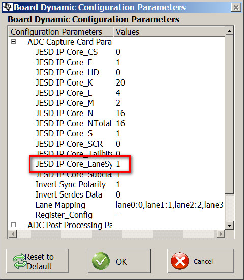

I'm using the TSW14J56EVM with a ADS32JB69EVM. When I select the ADS42JB69_LMF_421 and then look at the "Dynamic Configuration" dialog, there is an item "JESD IP Core_LaneSync" parameter that is set to 1. What is that parameter for? All the others make sense.

    If you have access to the user's guide for the MTI JESD204B IP, the "JESD IP Core_LaneSync" parameter writes to register 0x34. This register determines whether lane synchronization is enabled or disabled. This affects the rules used for character replacement defined in the JESD204B standard.

  • Dave,
    If you are not already doing this, you have to invert the dev_sync_n signal from the altera Megacore IP to the ADS42JB69.
    Eben.

  • Dave,
    A few things to try:
    -Probe the output of the 8B10B decoders to verify if the ADC is sending 0xBC to the FPGA on all the active lanes with dev_sync_n low. If it is not sending 0xBC, push the hardware reset (SW1) on the ADC and use the GUI to re-program the ADC again
    -Verify that sysref is connected to the RX core in the FPGA and there is a clock running on the sysref pin.
    Eben.
  • Eben,
    That was an extremely helpful suggestion! It let me see what was going on and I now have sine waves after 2 weeks of banging my head against the wall. I'm new to the Quartus II tools (about 3 weeks) and did not realize I could look at signals inside their cores.
