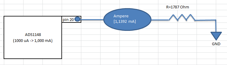

I'm configuring ADS1148 to enable pin20 and pin19 (IEXC1 and IEXC2).
I have this problem:
- Configure with MUX1 VREFCON = 01
- Configure IDAC0 with IMAG = 110 (1000uA)
- Configure with IDAC1 I1DIR = 10x0 and 10x1 = I2DIR
I read an output current greater than 1000 uA (about 1,316 uA). What am I doing wrong?
thank you

    Have you read back the register readings to verify that they are correct?  How are you determining the current?  One possibility of error can be by assigning both current outputs to the same output pin by mistake.  In this case you would expect 2mA, but if the load has enough resistance to place the total voltage drop outside of the IDAC voltage compliance, then the current would be less.

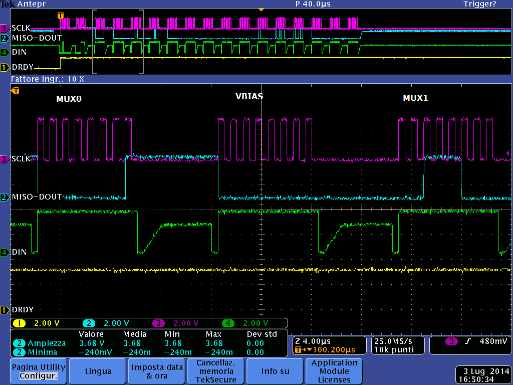

    What are the actual values you used for the IDAC register settings?  Do you have scope/logic analyzer shots of the communication that you can send me so I can verify the communication?

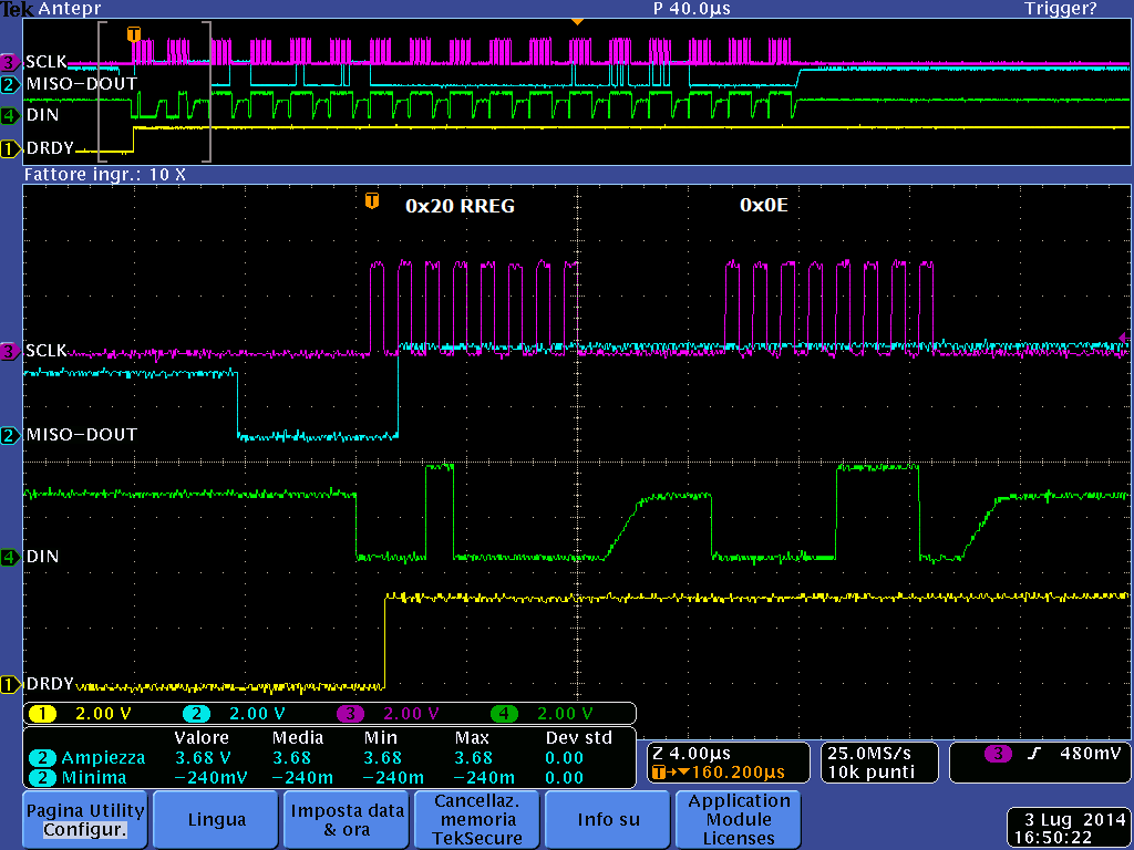

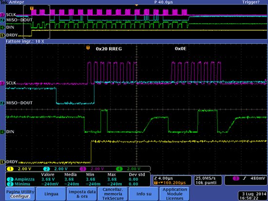

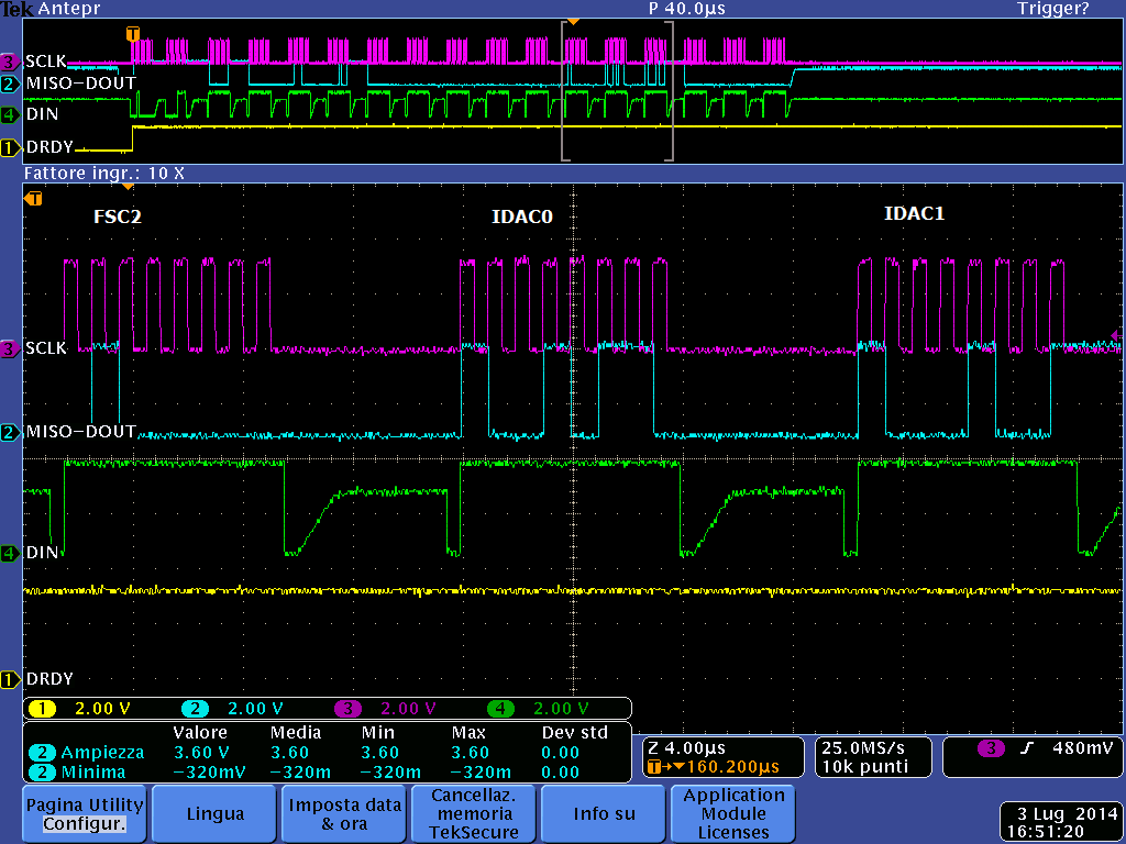

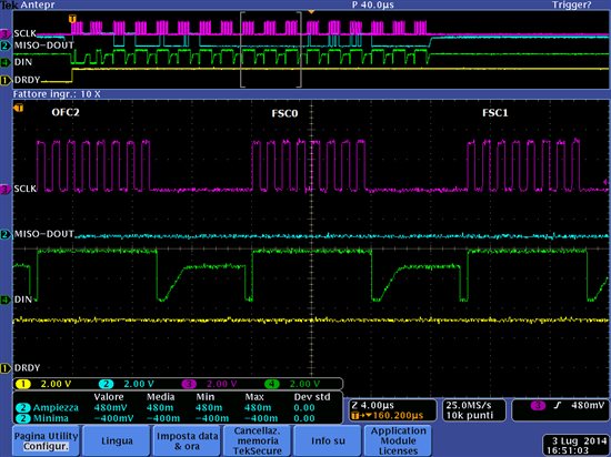

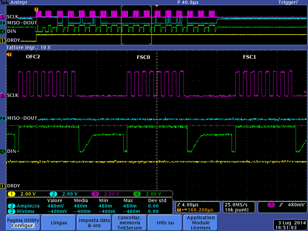

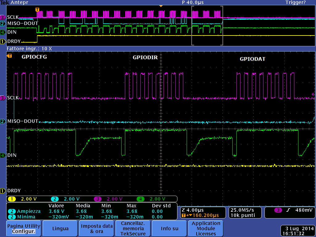

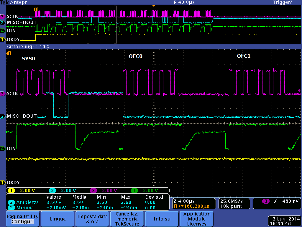

    I put in attachment as I am measuring the current, the response of SPI with all registers.
    MUX0.........01
    VBIAS........00
    MUX1.........38
    SYS0.........09
    OFC0.........00
    OFC1.........00
    OFC2.........00
    FSC0.........00
    FSC1.........00
    FSC2.........40
    IDAC0........96
    IDAC1........89
    GPIOCFG......00
    GPIODIR......00
    GPIODAT......00
    thanks
    fabio
  • Hi Fabio,
    The scope shots look ok.  What supply voltage are you using for the AVDD/AVSS supply?  Have you measured the voltage across the resistor to verify that the current meter measurement matches the current through the resistor by calculation?

    i have R=1787 (measured) Ohm, I=1.1392 (measured) mA V=2.041 (measured) Volt.

    In the original post you said you measured 1316uA, but in the last couple posts you measured 1139.2uA.  Was the first one a typo?  Make sure you have good ground connections, and that all your voltage measurements are refernced to the same ground point.  Also make sure that the IDAC compliance voltage is not exceeded.  The total voltage drop created by the IDAC source/load must be less than AVDD-0.7V.
