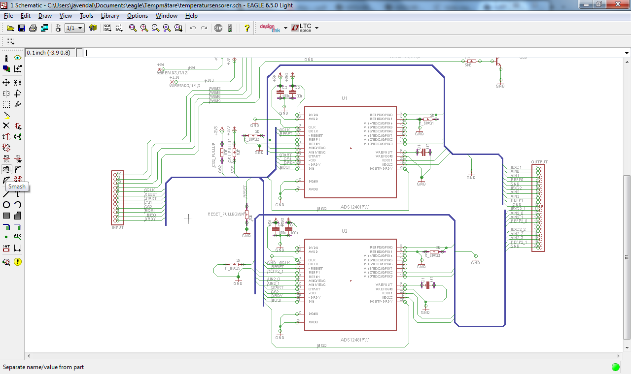

I'm new to the SPI-protocols. I have trouble to initiate communication between my Arduio UNO and the ADS1248 chip. Could you please have a look at my setup and check that everything is in order.
Thanks a lot for for the help!
6560.temperatursensorer.sch
  • Hi Johan,
    I don't see anything in your schematic that would prevent communication.  Before communication can take place, the device must be powered, the RESET pin must be high, and the START pin must be high.  There is also a wait period after power up before attempting to communicate.  This time is given in the datasheet.

  • On my PCB manufactured according to previously attached schematics I'm not able to pulldown the voltage on the CS-pin to more than 4V when the ADS1248 is soldered to the PCB.
    Does this imply that there is something broken in the chip?
    Regards, Johan
  • Hi Johan,
    It is not required to have pullups or pulldowns on the pins you mentioned, but having these resistors does allow the ADS1248 to power up in a known state while the controller is initializing.  The ADS1248 will not function if the RESET pin is low, so the controller connection to this pin must be set to logic high.  The START pin is like a power down pin, so for the ADS1248 to convert, or to read/write the registers, the ADS1248 needs to be powered up which means that this pin must be logic high.
    As there are two ADS1248 devices on your board, you will need to use CS to communicate to these devices separately.  Again, using the pullups will keep the devices from accidently driving the DOUT pins at the same time on power up.  The primary pins to monitor with a scope are CS, SCLK, DIN and DOUT.  You can look at DRDY to verify the device is functioning.  If START (and RESET) is high then you can check to see if the part is active by monitoring the DRDY line with the scope to make sure the DRDY pulses at the default data rate (5sps or every 200ms).
    If you cannot drive CS low, then you cannot communicate to the part.  Do you see the issue with both ADS1248 devices?  First you might recheck the layout to make sure that the footprint matches correctly for the ADS1248.  The CS pin is a CMOS input pin with some ESD protection circuitry.  If the ESD structure is damaged, then you might see an issue.  This could have happened if the Absolute Maximum Ratings were exceeded.  One way where the Absolute Maximums could be exceeded is by initially powering your digital with 3.3V while attempting to control the ADS1248 with 5V.  This would force the ESD diodes into conduction.  Long term excessive current will damage the ESD cell.  So it is possible that the device was damaged if this condition occurred.
    Bob B

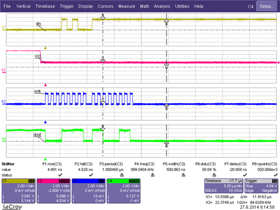

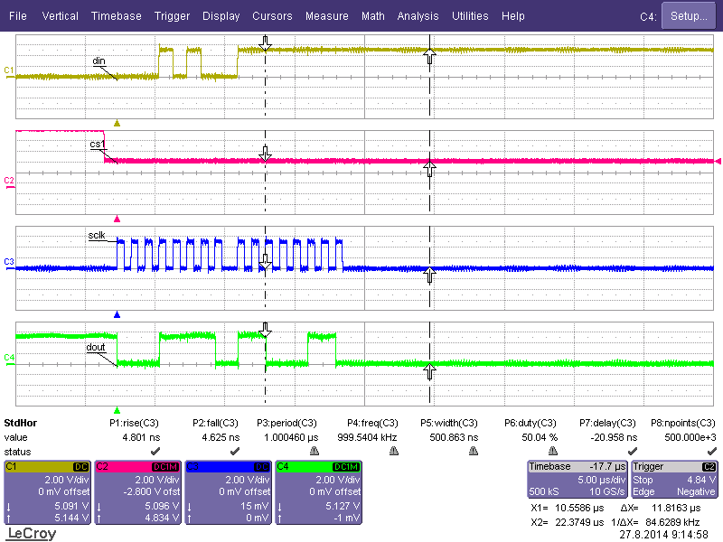

    Here's a screen shoot of the communication. DIN and SCLK are measured close to the chip and CS and DOUT are measured close to the controller. The offset voltage shown on CS1 is incorrect. The signal indeed varies between 0V and 5V.
    I send a RDATAC command followed by a NOP to pull DOUT high (I've set the DRDY MODE bit to 1).
    So I believe I should have only 0 on DOUT when I send the RDATAC-command? Do I need to empty the register before I send the RDATAC-command?
    Clearly I'm doing something wrong. What are you thought on how noisy these lines are?
    thanks for your support!
    /Johan
  • Johan,
    Just to let you know, the plots look ok. I would not suspect noise to be corrupting any data. However, let me point out two things.
    First, the default readout of the ADS1248 is with RDATAC. So when the device starts up, SCLKs will immediately start clocking out data on the output register.
    Second, if you do issue an SDATAC, it doesn't clear the data from the output register. It simply stops updating there. So if you had issued an SDATAC to stop data, you'd still need to clock out the data to bring DRDY/DOUT high.
    Going back to your plot, it looks ok depending on what you had asked the part to do.
    If you had just started the part, the default would have started the device in RDATAC mode and the device would started giving data immediately when SCLKs were clocked in.
    In the case where you were expecting 0s to come out, you would have had to start with a bit of setup. First, you would have had to send an SDATAC command to stop the data from being updated on the output register, then you would need to wait for the next /DRDY to finish the next conversion. Then you would need to clock out the last conversion so nothing remains on the output register. After setting up the device this way, you could restart the RDATAC. Then issuing the command, DATA comes out after the RDATAC command and not during it.
    If you're having problems with bad data, there are a few things I would try. First, get the scope shot of the bad data similar to what you have. However, if you only have 4 channels, then I would drop the /CS line (and assume that it's correct) and get the /DRDY line. It's a bit more important, and more people have problems with syncing the data retrieval with that line. That's where I'd start, especially when the data error is intermittent.
    If the error always occurs, I'd look at the offset calibration register and the full-scale calibration register to make sure the values make sense. If they don't, I'd check to see if they are written to or if there was a calibration done to set them off.
