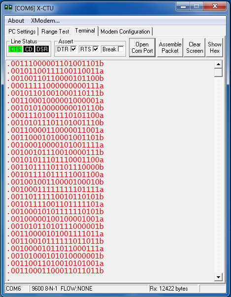

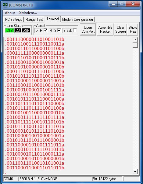

  • Sir, thanks, you have been "to the point". I couldnt understand it better even on reading datasheet many times. Ok! So, i interfaced photodiode to DDC112 which sends data to PIC16F873A microcontroller which sends data to serial port via wireless XBEE modules.  I am attaching a picture of some data taken, kindly help me prove your point discussed above about side A and side B. For example, my Side A data and Side B data vary a bit, they dont come same, then what should i do? Take the B data or subtract the B data from A data ? Or take the averages?
    The picture shows only IN1 data with a or b side shown at the last of the 20 bit data. When i expose photodiode to White light then it shows me full scale FFFFFh on both sides A and B. Just help me deduce data from the readings shown below. In this case, photodiode is simply placed in a room with tube light lit.
  • Shayan,
    Since you are using wireless and also converting the data a few times, It would be helpful to check the output at the pins of the device and make sure that the digital output codes are the same as the codes you are receiving at your PC X-CTU tool. Another helpful idea is to convert the binary output into Decimal values. It will be easier to see than a 20 bit binary number. By default when the inputs are connected to ground, you should get a decimal output code close to 4096 plus or minus about 1000 codes. This will change when you add a sensor since you will be adding input capacitance and injecting some input charge. The A-side and B-side are in parallel but will have some offset so what you can do is either use only one side, or you can take the average. Do not add or subtract the sides as they should be similar and should follow each other when the light intensity increases or decreases.
    -Adam Sidelsky
  • I checked the data, its fine. Also, when i connect the input to Ground then it shows me 0x00000H rather than 0x01000H probably because i have not created a bipolar range. Averaging of a particular side seems to be a good idea. I will do that.

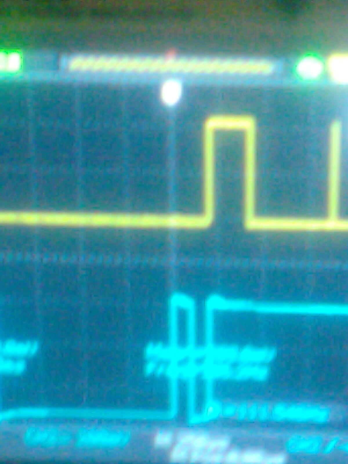

  • Here are the scope responses you requested, i am attaching them:
    CONV v/s DVALID:
    This above is what i get when I make CONV HIGH for 500us and put it back LOW.
    2) This image below is what i get when i apply a initial LOW to CONV and make it HIGH for 99us then LOW for 99us then back HIGH. Tint=99us (non-continuous mode) suggested by datasheet. You can see that DVALID remains LOW all the time and gives HIGH when data is ready which is the opposite of what i should receive.
    I hope the images are visible enough to conclude result. I did vary CONV patterns and timings but still i cant get the perfect DVALID pulse. I am using the NON-CONTINUOUS mode of data retrieval in my program. Also., the datasheet opposes itself many times which makes it even difficult to get the perfect logic. That's why all i request you is to give me an authentic ALGORITHM for triggering CONV. I have checked all the other things you mentioned. I hope a fruitful result will be obtained before my project deadline goes off. If you know someone on this forum who has interfaced this DDC112. then he might be helpful in telling the ALGORITHM.
  • Shayan,
    For either continuous or non-continuous mode you need to keep CONV running continuously. The system needs 3-4 CONV cycles before it will consistently output DVALID and data will be real. The reason for this is that there are many internal nodes that need to be synced with CONV and it takes a few cycles for them to be aligned correctly. This is the reason that your DVALID may not be working correctly, the data isn't ready after just one or two CONV cycles. You can do a search on the forum for others who have done this but I cannot recall a concrete example.
