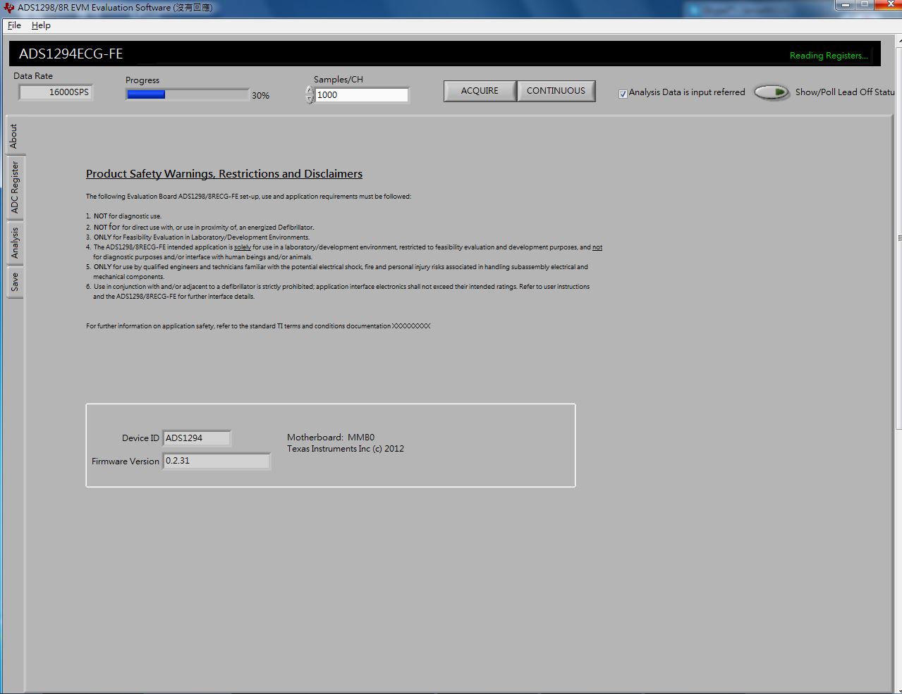

    If I did not press the RESET button on the MMB0, the PC GUI will spend about 5 minutes to read registers, such as the picture below:
    After it finished reading registers, the PC GUI got the wrong information, that is Data Rate=16000SPS, Device ID=ADS1294, Firmware Version=0.2.31. You can see the picture below.

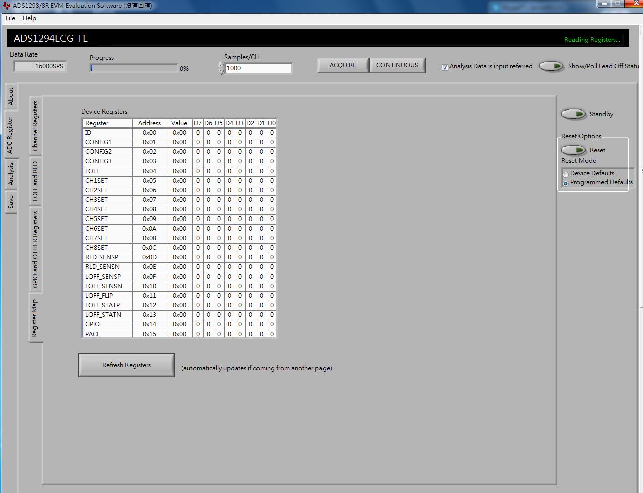

    At this time all Register Map were 0x00,

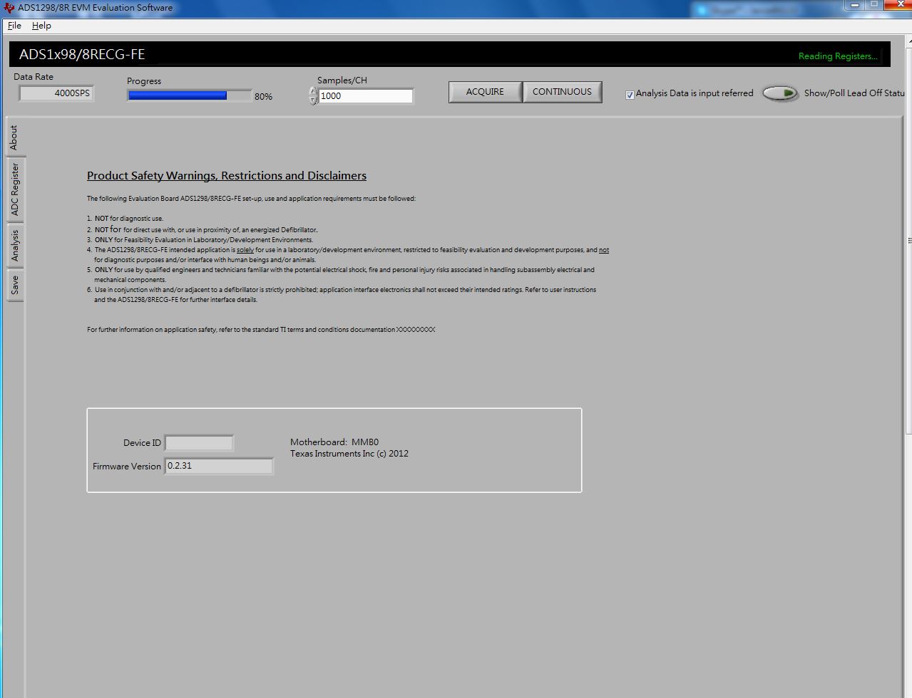

    When I press the Reset on the PC GUI at this time, the error message will come out (error code 6004), like the picture shows below.
