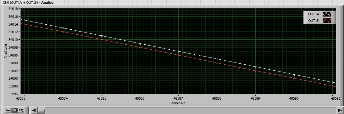

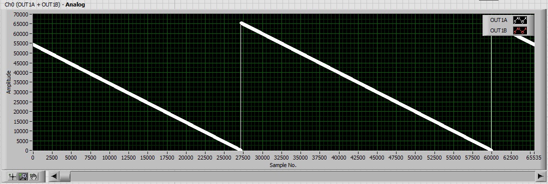

    Many thanks for the cheking this up and brining the issue uo during preparation of a new release of the datasheet. In the meanwhile -- I am more and more multitasking, hence the delay -- I was again playing the the ADS5263 EVM board and a Spartan-6 chip with my deserializer running (all hooked-up to LabView for display). I detected odd behaviour of the ADS when operated in the RAMP PATTERN mode.Here is the question
    My question: Is this possible at all that my ADS5263 operated in the RAMP PATTERN mode actually is generating data that DECREASE (instead of increasing, as suggested in ads5263.pdf, p. 25)?
    Here is the description of experiments done:
    I am using the ADS5263EVM software to change the op. mode in the ADS chip. I am using WORD-WISE mode, 2-wire serialization, and analysing channel 1, only. Offset Binary format is selected, but this setting does not affect the operation of the chip in test modes -- IMHO. Everything looks fine with a SMALL exception (vide #3):

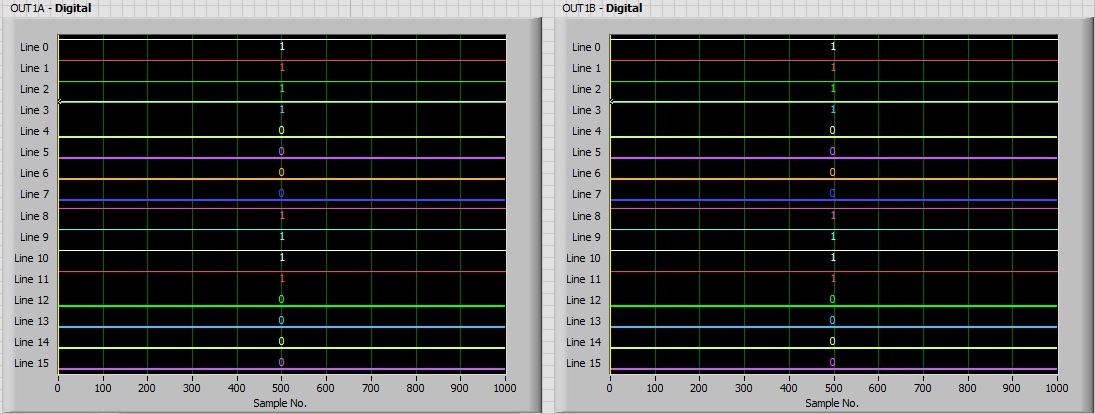

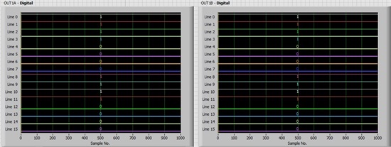

    1) here is my SYNC PATTERN (just selected 1000 samples out of 128MB block collected in one go)  data appearing in OUT1A i OUT1B are as they should be (Ox0F0F):

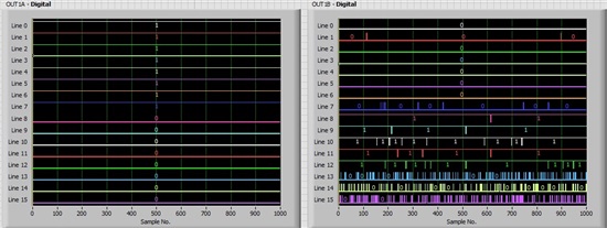

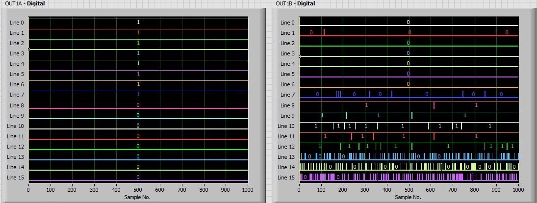

    2) when I switch into the 1-wire mode, then again I get the correct stuff (0x00FF on OUT1A, and trash on OUT1B):

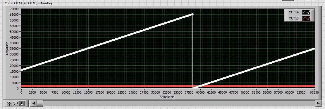

    3) However, when I swith into the RAMP PATTERN, what I got for the 2-wire is this:
    and a close-up:
    Well, this looks fine, OUT1A and OUT1B are monotonically changing, since this is WORD_WISE mode, the they change by 2, but OUT1A is odd, while OUT1B is even. Fine... but according the the datasheet, the RAMP PATTERN produces data that should INCREMENT. What I see is that they decrease!!!
    To eliminate any possibility that my FIFO's, DRAM's are reversing the colleced data before sending it to the PC, I run a simple experiment: I was analysing the ADS data, but instead of using the samples from ADS I was using FPGA-generated data coming from a simple counter. Except for the source of the data, everything else in the code was unchanged! Here is the result:
    When the data are coming from myself (and they are 100% increasing -- I generate them this way), what I get from the FPGA is also increasing. In my opinion this proves that my data-pipes are working fine.
    My question repeated: Is this possible at all that my ADS operated in the RAMP PATTERN is generating data that DECREASE (instead of increasing)?
    I will appreciate hints and suggestions.
    Pawel Kopyt
  • Hi Pawel,

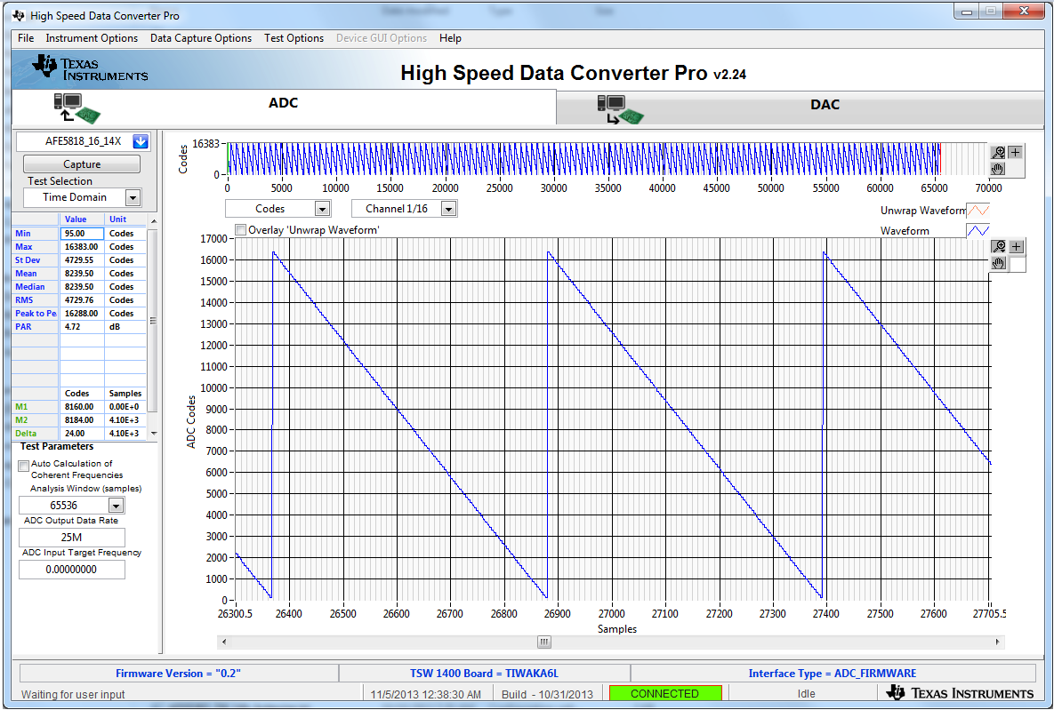

    I think it is highly improbable (although I wouldn't say impossible) that the device RAMP test pattern is changing.  I  actually managed to capture exactly the same decremented RAMP test pattern on another LVDS device which only supports 1-wire mode.  This was achieved when I inadvertently inverted the positive and negative Frame clock pins to the receiver.  Can you try swapping these pins on your deserializer?  Finally, you mention providing a test pattern from within the FPGA to check for inversions.  Does this test pattern bypass the front-end deserializer?
    Christian
  • Hi Christian,
    Many thanks for the response and thanks also for the suggestion.
    Yes, I tried to swap them. This resulted only in a change in the order of the LSB/MSB received by the PC. When I corrected for this, I again got my RAMP but decreasing.
    What is interesting is that the period of my ramp signal is exactly as it should be -- 65536/2 (the decrease is by 2). If it were some jugglery with lo/hi bytes I doubt if the period would be preserved. Do you agree?
    Also, looking at your data, it seems that you were working with 14b device probably, and by playing the Frame CLK, you got also a signal that is decreasing by 4 (while in the very beginning it should increase by 1 -- is that correct?). what puzzles me is that in my case I got signals exactly as they should by (period, the chage per sample), but the direction is opposite...
    The data at the end were coming from a counter (and not from the deserializer), but the clocking signal was coming from the ADS.
    Pawel Kopyt
