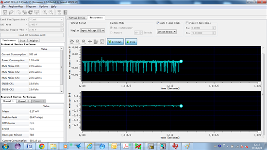

Currently I am working on ADS1293 EVM board. I remove the ADS1293 chip on EVM board, and connect my ADS1293 board I designed based on the evaluation board to the ADS1293 EVM board.
The captured ECG image is as follows:
What could be wrong or how could I find out what is wrong?

  • Hello KM,
    How did you connect your own ADS1293 board to the ADS1293EVM?
    The first thing I would verify is for correct register write and read functionality. If this works fine, next I would use the test signals configurable in bits [7:6] of addresses 0x01, 0x02 and 0x03 and capture data. The positive test signal is 200mV, the negative test signal is -200mV and the zero test signal is 0V. If this works fine, then I would verify the external signal connections.
