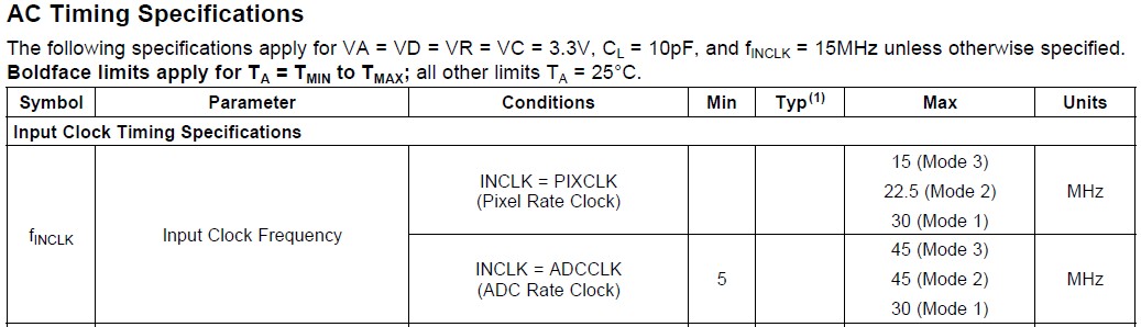

    You may have mis-typed the INCLK (50kHz). Here are the INCLK values in the MHz range:
    Hooman
  • Hi Hooman Hashemi
    Thanks for your feedback..
    My INCLk is 50Khz only ,
    in the above table for INCLK = ADCLK minium clock is 5MHz
    but for INCLK = PIXCLK minium clock is  mentioned in the table.
    and the settings what you have provided is for which sensor CCD/CIS & in which mode CMOS or  LVDS.
    Govind Raj
  • Hi Govind,
    As you have noted, the LM98714 would not work with INCLK of 50kHz. May be you can explain what you are trying to do and what dictates your low INCLK frequency and we will get back to you with your suggestions.

  • Hi Hooman Hashemi
    As you have suggested, i made INCLK= 8MHz, and initialized the LM98714 according to the figure 64.
    My configuration details are given bellow.
    Page 0:
    Main Configuration 0 = 0xF1.(Mode 3 in forward mode and one color sequence).
    Main Configuration 1 = 0x05.(O/P format is CMOS, INCLK = ADCLK).
    Main Configuration 2 = 0x08.(Device active,O/P enable,Device fully powered).
    Page 2
    SH Mode = 0x80( SH o/P pin to tristate,SH source select to external).
    CMOS Data Mode = 0x20.(CLK10 is configured as CLKOUT).
    Am not using the CCD timing generator so i kept all other registers to default.
    After all this configuration, starting the scan by using start scan bit in
    Main Configuration 2 = 0x01.
    Am polling the ready bit after start scan, and it is working as expected (shown in fig 64).
    I am observing some pulses on output pins but am not getting any pulses on CLKOUT pin.
