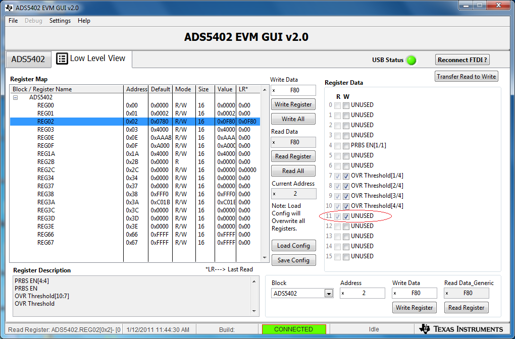

    For the ADS5401, the device would probably function at a sample rate higher than the datasheet max but the device was only tested and trimmed for the data rate listed in the datasheet.  There could be no guarantees that any one device would work past the data sheet max limits.  The ADS5409 is tested adn trimmed in manufacture to support the higher data rate adn meet the datasheet specifications at that higher data rate.   I believe there *is* a way to turn off one of the two channels if you do not need two channels and of course do not want to burn the power for an unneeded channel.  There is a register bit in the SPI register space that can turn off channel B.  I expect this was thought to not be needed in the datasheet since there are single adn dual versions of the device - but as you noted we didn't make a single version of the device at the 900Msps sample rate.  I am told that we could add to the datasheet the description of the bit that would be used to turn off channel B.

    1. For the ADS5401, the Max sampling rate in the datasheet is 800 MSPS. We want to confirm that TI has each of ADS5401 tested at this Max sampling rate?
    2. Could TI let us know the way and the internal register bit that to disable the one channel of ADS5409 as soon as possible, in advance, before the updated version of datasheet issued?
    Thank you very much.
    Jason
    The device will always be tested to support the max sample rate shown in the datasheet.
    The register bit to turn off channel B is in register address 0x02 and is bit D11.  Set this bit high and the ADS5409 becomes a single channel ADC with only channel A active.   I just tested it on the bench, going back and forth between one channel active and both channels active.
