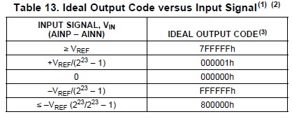

Single input INP : swing around 2V(limited from 0V to 5V by prestage OPAMP)
1.1   when I use internal reference 4V and connect INN to 0V,
INP swings around 0V? so it loses signal under 0V?
1.2   internal reference 4V but INN to 2V common voltage same as INP,
INP swings around 2V? in theory, range is from -2V ~ 6V but in practice, 0V~5V? or 0V~4V?
Which one is right?
1.3    Vin = INP –INN
At 1.1 Vin = INP -0V = INP and at 1.2 Vin = INP – INN = INP – 2V(AC signal swings around 0V). which one is right?
And in which situation will I get 7FFFFFh code? Over Vref 4V?
2.1 internal reference is 2.4V and INN is connected 2V
     What is INP range? Theoretically -0.4 ~ 4.4V but in practice 0~4V? or 0~5V?
     And here when INP is over 2.4V, output code is 7FFFFFh?
