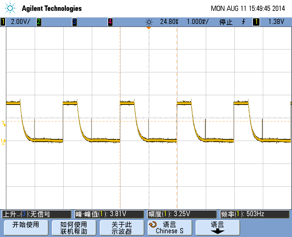

Hello:

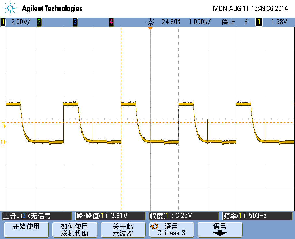

  AFE4400 LED on/off wave is different with the( slau480c.pdf)?the register is configured as the AFE4400SPO2EVM.
what's the problem?
  • Hello Minsun,
    We have received your inquiry regarding the AFE4400.
    Can you provide more information on the four waveform plots?
    Praveen.

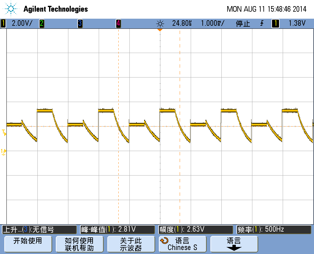

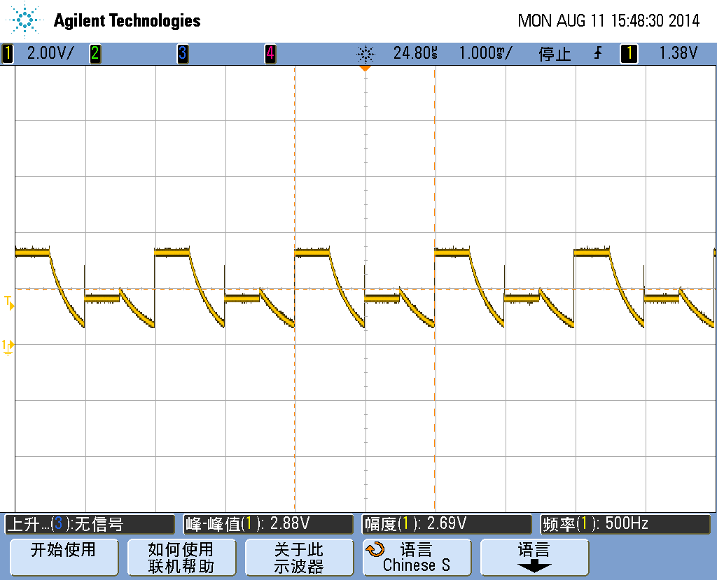

  • fig.1 fig.2 at TX_P (TP23) and TX_N (TP17) without sensor;
    fig.3 fig.4 at TX_P (TP23) and TX_N (TP17) with sensor;
    page 38 of the slau480c.pdf.
  • sorry,
    fig.1 fig.2 at TX_P (TP23) and TX_N (TP17) withsensor;
    fig.3 fig.4 at TX_P (TP23) and TX_N (TP17) without  sensor;

  • Hi Minsun,
    Your setup is properly. We think the difference between your result and Figure 47 in slau480c.pdf is caused by a sensor and circuit condition such as parasitic capacitor, pull-down resistor value and so on. When sensors are connected and LED1 node completes sampling ambient signal (LED2 node starts ON state), TXP node becomes (Vcc - Vf)[V] due to the current controlled by a norator between H-bridge and GND. Thus the TXP and TXN nodes display (Vcc - Vf)[V] as your waveform.
    On the other hand, we could not also see same waveforms like Figure 46 in slau480c.pdf for the no sensor connected scenario. We saw similar waveforms like your fig.1 and fig.2. The waveforms which are indicated in Figure 46 in slau480c.pdf are similar to the (TXP - TXN) result. So I will confirm whether this is a compilation error or not.
    And I will update the Users guide as soon as possible.
    Thank you for your notice!
    Takashi Onawa

  • Takashi:
               thanks .I wonder if the sensor's sensitivity can be changed by the waveform voltage?it can changed by current control and timing control.as i say,i had changed the current value,but the voltage didn't change.in my opition,change current can change the waveform voltage .

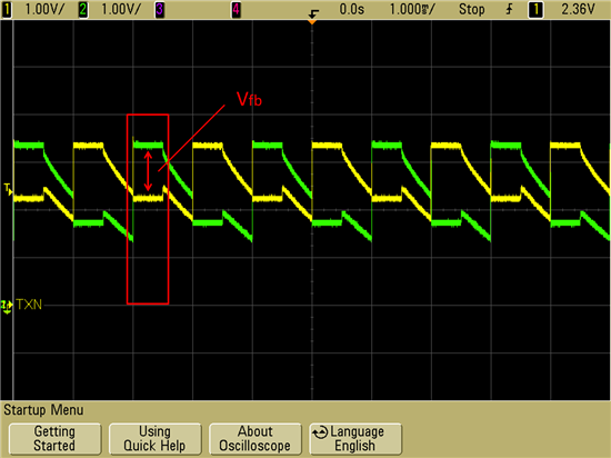

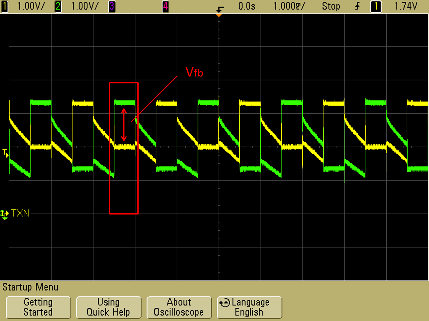

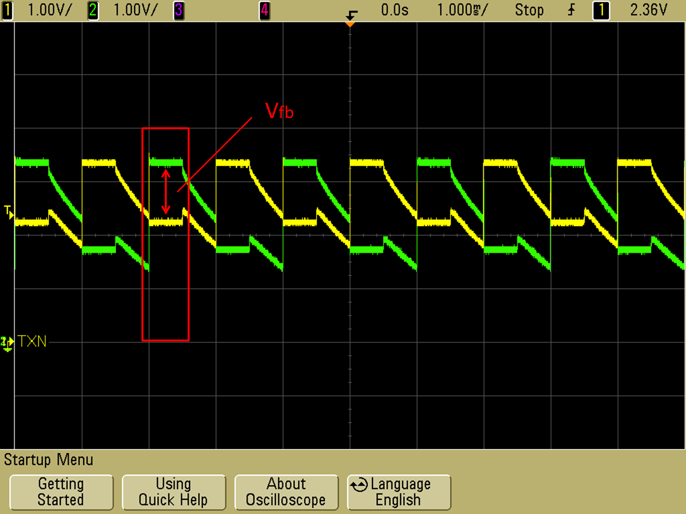

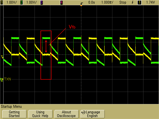

  • Hi Minsun,
    Intensity of light radiated from LED doesn't relate to the voltage but its current.
    The voltage can not be changed by controlling the current expect a term which is indicated in a capture below.
    Fig. 1 LED current : 1mA
    Fig. 2 LED current : 25mA
    The waveform voltage is determined by a Vcc voltage and Vfb of LED, so we can only see some variation at a period framed by red circle.
    Vfb relates to LED current; this characteristics is typically indicated in datasheet of its sensor. the voltage must be Vcc-Vfb [V] in the period.
    By comparing the two figures, we can exactly confirm that the Vfb voltage increases with the increasing LED current in the period.
    If you are concerning about power dissipation, you can reduce that by controlling its current or ON time of LED.
    Takashi Onawa
