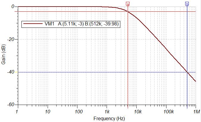

I bought the ADS1298 chip and used it with ARM MCU and transferred data to a computer in short input mode. I want to use external electrodes to capture data in normal mode.
Should I place a simple RC anti-aliasing low-pass filter before the input pins of ADS1298 ?
If I place this filter, regard to ADS1298 internal modulator frequency, how can I calculate the filter's which is the appropriate cut-off frequency for this filter? My desired Data rate in ADS1298 is 2kHz..
