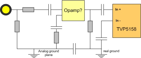

we are using a tvp5158 in a design for an automotive application and our schematic is derived from the evaluation module's, analog input ground is not isolated from the rest of the board (there's just one ground plane).
Now we are interested in adding overvoltage protection to the analog inputs to try and survive shortcircuit to battery (16v) tests, but we have no idea where to start, we are new to this protection of analog inputs.
Are there any guidelines or reference designs for making analog video inputs robust to overvoltage? thank you for any help.

  • Hi steve! thank you for your fast answer,
    automotive normatives specify electric tests that include shortcircuit to battery Vcc in every input and output pin, that's why we were wondering if anyone could help us with a protection circuit to avoid frying the TVP (I think it specifies 2V5 max input voltage).
    ESD protection has been included, AC coupling is copied from the reference design, main voltage regulators are designed to absorb 80v peaks, and we have seen a device that has a separate ground plane for the analog input before something like an opamp
    anyone has any experience protecting analog inputs against overvoltage?
